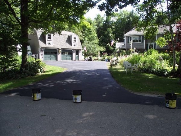

    20131004_014213000_iOS.jpg The man up the road just had his done. He has a big long driveway, about 100 ft and a large yard with turn around. Cost him $700.
    my wife and I did ours 2 yrs ago before I fell, Cost us about $150 for materials. Did it in a half day. So that is two very overweight seniors doing a driveway in 4 hrs. We took brakes.
    What I didn't say is the prep time. I did pressure wash and edge the driveway. I treated all the oil stains with a product I got for that at HD. I filled the cracks with some sort of goop that is sold just for that.
    The first year we did it ourselves, we used some airport grade stuff that was nearly $30 a pail, we use 8 pails. The stuff was thick and required a lot of pushing to spread it around. But it did soften up and spread around ok on the hot pavement.
    The problem is that it didn't hold on well. It came of in huge flakes. The odor was awful. Some plant nearby turned yellow.
    The next time I bought some cheap stuff. That went down easily and didn't stink so bad. That stuff stuck with no flaking. It has worn off during the past couple of years so it needs to be done again this year. You can walk on it as soon as it dries but can't drive on it for a day.
