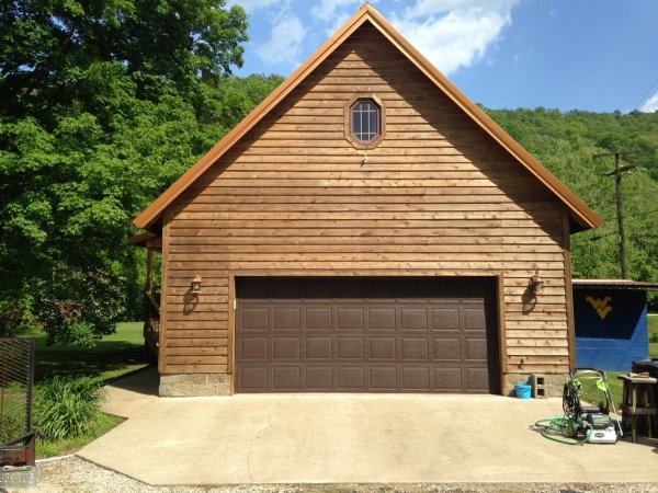

    IMG_5188.JPG Sir Backwoods Savage I just bought a Greenworks Premium Electric 2000 PSI and I could not be happier-it comes with 4 tips, including the turbo tip which is great for concrete-I got it on sale at Lowes for 149., $50 off but I believe the sale has ended-Mind you I'm cleaning cedar totally re-doing my house-pics to follow but the bottom line is this-I have a gas PW and every year without fail would need something...B&S engine...blah blah blah---I never thought I'd be content with electric...pull it up at Lowes, read the reviews--I could not endorse it more-diff tips will allow it to do what you need IMG_5195.JPG

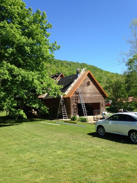

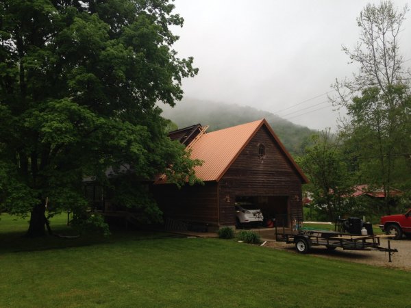

    IMG_5183.JPG IMG_5186.JPG Thats how bad it looked-course new roof going on since the wind storm March 1 that ripped most of it off...the tree is a maple that my grandfather planted in 1956, it means more to me than the roof, I had to trim it back marginally. First touch by human hand...hope she heals well...and understands....

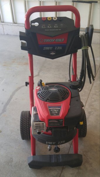

    This is what I have. Only beef is you have to pull the dipstick and flip it to change the oil.
    Sorry for the double pic's. Fat fingered it. Got it for a steal helping a friend move to Vegas.
