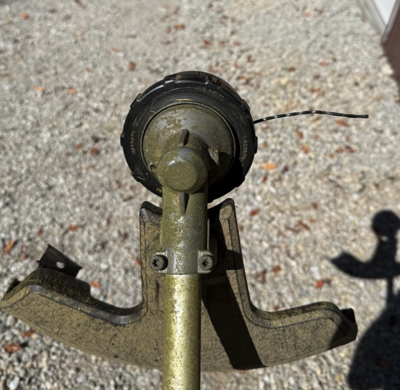

    Argghhhhhh. I ran a full tank through the 3020 no problem, stopped and had breakfast, and then this happened twice in about one minute of running:
    You can tell it's not user error from running the string too short.
    The second time it was stuck stuck so I ventured back to my garage and retrieved one of the electric trimmers. After a few moments the same thing happened:
    Infuriating.
    Conclusion: the entire speed feeding concept is a flawed, broken design. Here is why:
    When you are spinning the head to load it there is no tension on the line so it tangles in on itself slightly. Then, during use, centrifugal force causes it to tighten back up preventing any feeding from ocurring. Eventually, that side gets short enough without being fed out that it sucks back in. I suspect the more aggressive the line, the bigger a problem this is because it has friction with itself.
    The design could probably be fixed by the addition of a rotating cam-lock system with two positions; load and use. In the load setting, metal tabs would put tension on the line as it feeds into the head, and then during use, those same tabs would reverse, forcing the line to only feed one way. Actually you might not even need the second setting. Unfortunately the added drag would make feeding a chore.
    I'm just going to switch to the T35 manual loading heads.
    RCBS, eatonpcat, metalcuttr and 2 others like this.

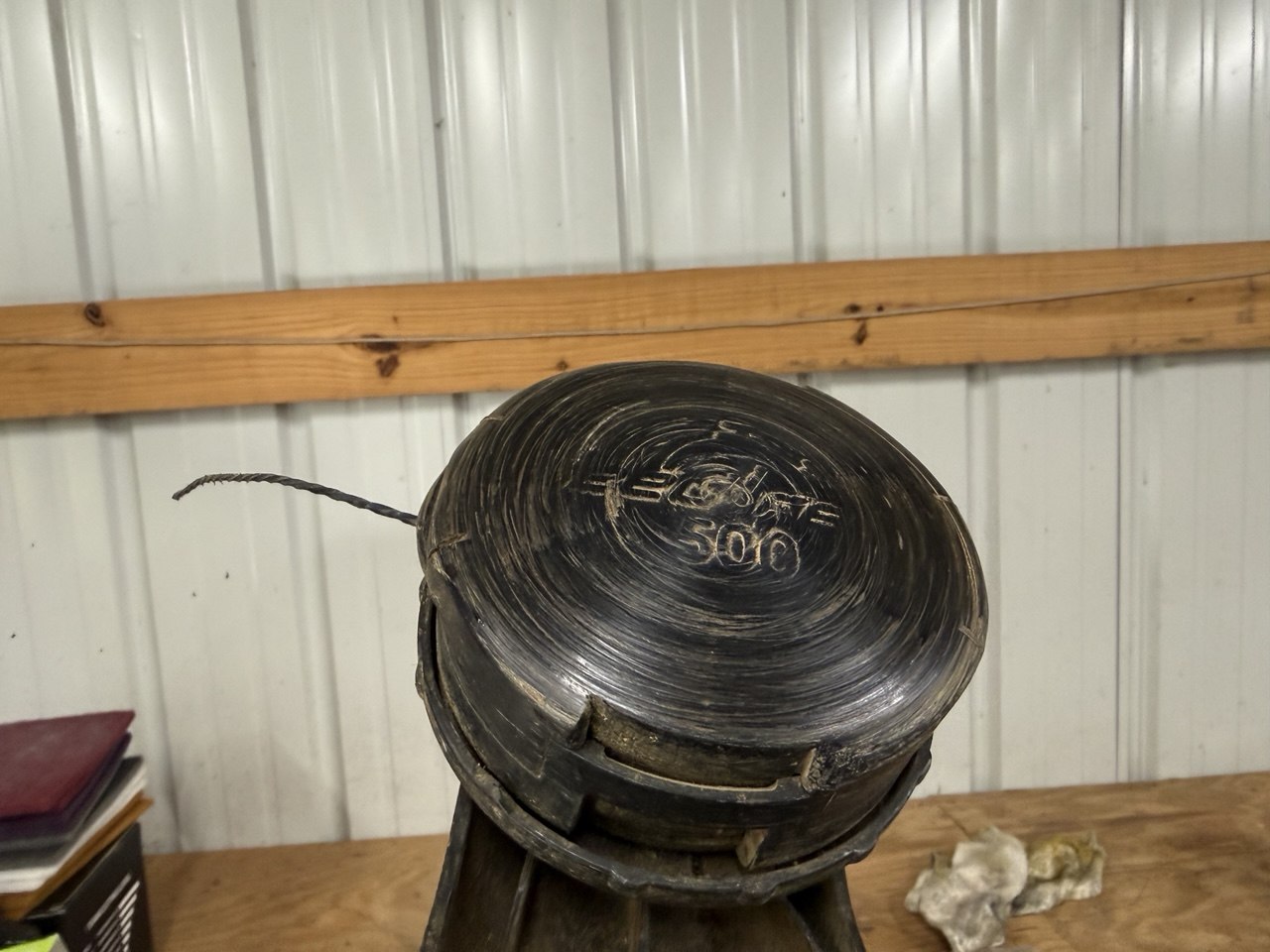

    ABSOLUTE BANE OF MY EXISTENCE. ARGHHHHHHHHHHHHHHHHHHHHHHHHHHHHHHHHHHHHHHHHHHHHHHHHHHHHHHHHHHHHHHHHHHHHHHHH
    This happens _every_single_time_ that I run any of my weedeaters on any of the three brands of heads I have.
    It appears to be somewhat heat related because I can usually cut for 20-25 mins and then this starts. I go rip it out and reload, and then it happens again pretty much right away.
