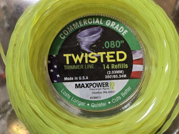

    Certiain lines will "weld" themselves together inside the spool from the heat generated during cutting. That's what it looks like is happening in your pics. Orange echo line was one that did it for me every time I tried using it. I tossed the spool in the trash. The Stihl line that came in my battery trimmer hasn't done it. That said, below is my go too line. I started using this because of a video by project farm on YouTube. He repeated the testing a year later with other brands and it still won that shoot-out. It has worked well. Not brittle. Doesn't weld together and ruin a spool full of line. Cuts well. It is a bit noisy. It's sold in larger diameter sizes as well as the .080 I use. 20250825_151037.jpg

    I can vouch for the Twisted MaxPower! Excellent line.
