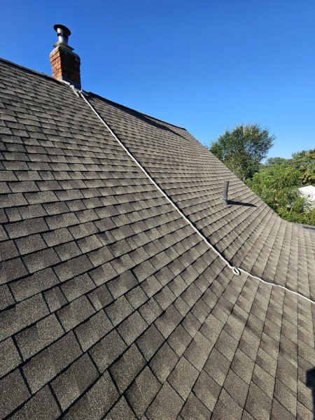

    I agree with the idea of cleaning every year till you are comfortable with your burning style, wood quality, etc. Way less expensive to have it looked at than oopsies.
    I'm not fond of heights either, but i'm absolutely not paying someone to go up there till I'm unable to myself.
    Last season was our third season burning..our first season included some less-than-perfectly-dry wood. I may well graduate to cleaning every other or every 3rd year, but for now, every year...looking to establish a baseline normal.
    Maybe you could install some permanent fall protection?
    I looped a rope around my chimney, with a length of hose where it chafes on concrete.....(pic). It helps with ascent and decent. And I can nip up there to clean, seal cracks, whatever.
    Shop around for sweeps. Or find a friend who knows a little bit about chimney conditions.
    Did mine today. If I'd had any repairs to make, I'd be really short on time to fix. We'll be burning on a couple weeks.
