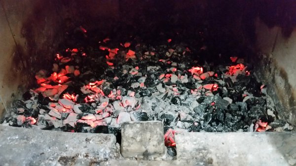

    This is what I had left after stocking her last night at 945 it is now 430 the next day. Closed the door walked away by 1015 last night. Just flattened em out and she is already going again. Wow that is amazing.

  18. papadave
    Pull 'em up to the front of the box before loading.
    That's pretty impressive.
    Heck, maybe I should be getting tips from you. Seems like once the light went on, you got this down.:thumbs:
