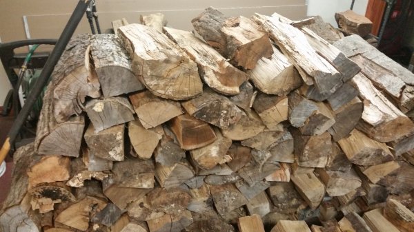

    So here is a pic of some of the splits that I use

    Ruff, you pretty much nailed it with the statement "I have been trying to figure out haw a epa stove operates...."
    When I switched over from a non-epa to an epa, I was finding all the excuses I could think of to remedy the improper burn but ignoring the "dry wood" factor. I mean, it burnt well in the non-epa stove, why would this be any different, right?
    You see this happening over and over again. People get all excited about buying an new stove and when it's finally hooked up, it wont burn right! The most common reason is the moisture content of the wood. It's just too wet for the epa stoves, so you have to compromise to burn it. I think by far and and by large, this is the most common mistake using epa stoves. It is no coincidence that so many threads are devoted to dry seasoned wood and burners being "years ahead" with their wood piles.
