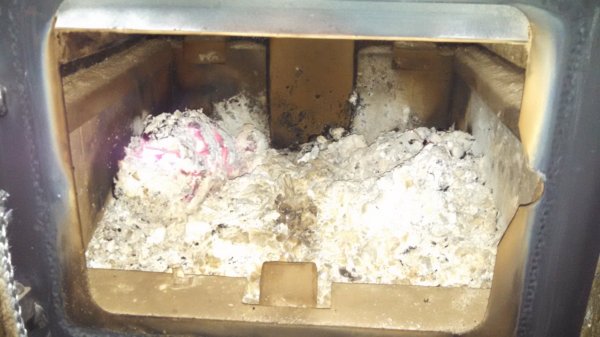

    Had to go back and try to see what the problem is. Sounds totally normal to me. The rear coals are the last to burn and the back corner bricks never burn clean on mine either. I also have to clean the white residue from the glass after a few days of burning.
    You have overfired that stove. The white spot on top means you got way over 800. The buckled and twisted piece inside the door is another symptom. No harm though.
    Oh and I burn at 700 all the time. Tip of spring even with edge of ash lip. She likes to run hot.

    So if that warped piece has a job what is it? Because all I see is a 90° piece of iron that has three crappy welds on it, is warped, and taking up space in my eyes. Also on the other forum there hearth.com I read where a guy took his off and nothing ill came of it.
    Overfiring? I read a forum topic here, that is why I joined actually that was 23 or so pages long about a guy and his nc30 maybe "papadave" was the name I think. And in that topic I saw pictures of guys stoves that were literally packed to the tubes. And I was shocked they don't overfire. So how is it that I am, when I only put 8 pieces of wood in? I am baffled lol.

    Here's a pic of mine this morning. The piece on the left still has some lazy flames after I opened the air. The glass is fairly dirty too, which means I shut it down a bit too much.
    A controlled, hot fire, will burn off most of the stuff on the glass, but since the house is still 72, that ain't happenin'. :D
    What generally happens, is that if the wood isn't dry enough, the fire needs more air. If it doesn't get adjusted after the water is burned off, the stove will get very hot...maybe to the overfire point. Before I learned that (this was the old stove), I added more wood to the fire, then after a while...BAM. The gates of hades came alive inside the stove, and it got REAL hot. Pegged the thermometer.
