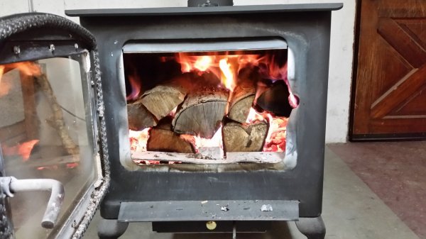

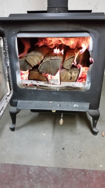

    Here is some loaded

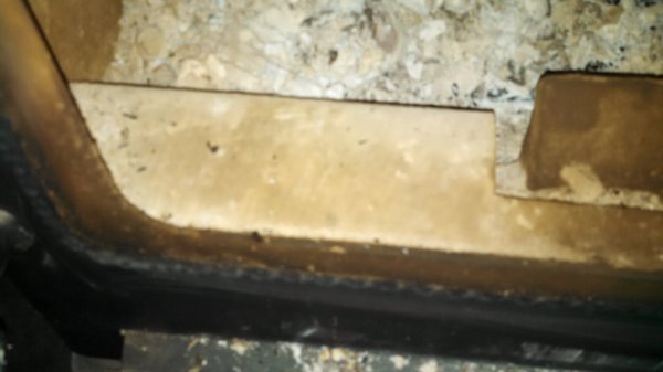

    I just bought a nc-30 so the next question I ask is out of ignorance.....but is the discoloration around the bottom of the stove opening indicative of needing a new door gasket? Or maybe a gasket that is beginning to weaken?

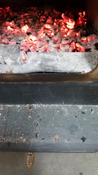

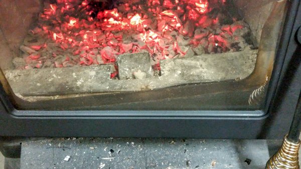

    I'm seeing signs of overfire in the front of the stove just inside the door.......This is what it should look like, and yours looks warped......I can see fire through the gap.
    Here's where I usually set the air on an overnight burn. The rod is about in the middle of the spring.

    Wow, I didn't notice that, it sure is warped.

    Well the weld broke on the left side and the right side warped. Honestly no offense to anyone I love this stove and I hate this stove. It is so hard to figure out. I never ran an EPA stove. First one was a hearthstone h1 and the second one was an Ashley wood circulator.

    Warpage

    Pretty sure that piece is there for decoration, I think I'll be angle grinding the remaining two welds off and pulling that off and out. People say overfire but I read on this site 750 is the norm and that number scares me. And that stove runs there. I see pics on here of the stove loaded to the tubes on top and I just don't get it. How am I overfiring if I am closing down the air too much making unburnt wood in the back of the stove?

    If that metal is warped like that, it's been overfired, no matter what the thermometer says.
    There's nothing on this stove for decoration, unless yours came with the little gold-ish colored strips along the front lips.
    I usually run mine about 500-550, although it sometimes gets up to 700, if I forget there's a fire in the stove.
    This stove is very easy to run with dry wood.
    After thinking on this, I don't think you are closing the air too much (based on the pic you posted), rather the wood isn't dry enough.
