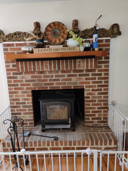

    Holy cow I haven't been on here for quite a while, I hope everyone is doing well. I have a quick question looking for some ideas and a solution.
    I have a nc30 slammed into a brick fireplace with the larger blower on it. However due to putting it back in the fireplace I cannot access the controls once a fire is started. How would I go about making an extension to run a switch outside the fireplace? I'm not the most electrical savvy person so excuse the simple question.

    simple way is to set fan to high speed then plug it in to a remote AC speed control unit which is nothing more than a SCR variable light dimmer for the more diy inclined persons.

    Ok so do you know what kind of amps it would need to be able to power the fan? Seems simple enough as long as I get the correct one

    snap disc in series on one line, does not matter which side.
    Off hand amperage wise just the common SCR dimmer control by itself would be sufficient I would highly doubt that it pulls more than 3 amps.
