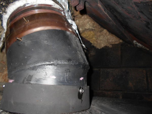

    a nice new cobalt bit will drill that just fine. Just my opinion but I would either have a fab shop weld up an elbow or order one the right degree. I know when you get this close you want to get it done but it's not that cold out, take a breath and do it right.

    It doesn't have to be stainless, mine is made from 3/16 steel. I have a church friend that has a fab shop.

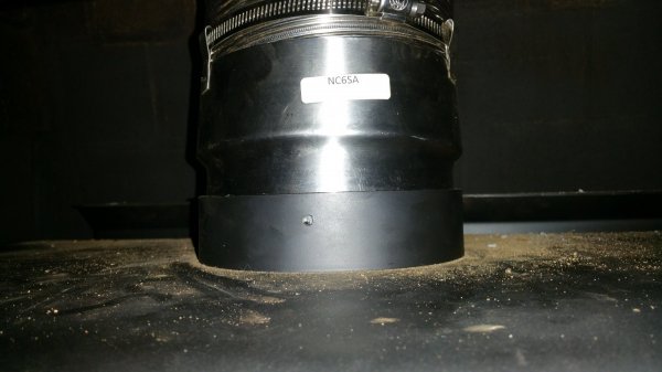

    This is where im at

    Dont know what to do. Cant get it to sit flush the clearance to install is crap and im starting to get frustrated...

    Yep looks like you need about 15º degrees. Just remember you are playing with fire here.
  7. brenndatomu
    25,301
    164,693
    There are 15 and 30* SS elbows on the fleabay for $38-39 shipped...

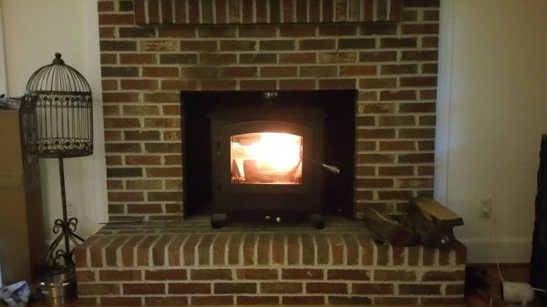

    Well the 15 degree elbow arrived and worked like a charm! Got it all seated and installed. 59 in the house do FINALLY started the first fire!
    I cannot thank everyone enough. You all have helped me so much and it truly is appreciated. Im sure i will have many more questions down the road and know I can get them answered here!

    Glad you got it done, the fire looks great, did the door seal work OK?
    wildwest likes this.
  18. wildwest
    30,744
    145,238
    Congrats!!!
    I cannot wait see how this winters heating bill turns out for you, windows can wait!

    Looks good!! Do you have a short leg kit installed?
