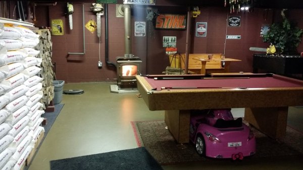

    Pass the popcorn please 20151130_210835.jpg :)

    Cool pink car! Christmas gift for this year?
  10. DexterDay
    DexterDay Administrator
    12,411
    31,637
    Northeast Oh
    Nope... That's was last year (for my 4 year old daughter). :)
