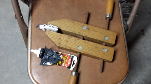

    I'm never using that Imperial stuff again, so thick I can barely get it out of the tube.
    The first time I used it wasn't that bad, when I bought my used stove, I had to replace the gasket but I kind of screwed it up so the next year I replaced it again,, but that one the same brand was very hard to get out of the tube, I wasted some screwing around so, I had to use some from the older tube left over and I had to cut the tube open to get that stuff out.
    Squeezed it out with a clamp.
    Now I have a couple of spots coming loose a little that need re cementing
