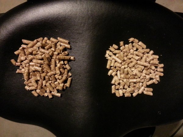

    Good to know
    Now here is a pic I took last week of some Inferno Gold and the Corinth from a spring of 2014 purchase. The lighter ones are the Corinth

    Those Corinths are very light in color! This morning I stopped by a TSC I had been to in July when I was scouting inventories for the early buy. In July, among other things, they had a couple tons of AWF hardwoods leftover from last season, so I had put a ton on layaway. It was like the place was frozen in time. Everything was still there from July, I had to do a double-take to confirm the pallets still have the July date written on them. Never seen anything like this before, the product just isn't moving. Anyway, I got my layaway refunded and then stopped at the local TSC and picked up 2 bags of the Currans in TSC bags, that are labeled 100% hardwoods. Not sure these are really 100% hardwoods, I cut a bag open and they are very salt and pepper looking. When the hopper is empty of FSUs, I will throw these in and see how they do.

    Yeah and they burn really clean and heat output is great for the price paid, although not as hot as LaCrete. I paid 249 for them last year and bought a ton-I should have bought 2-3 at that price.
