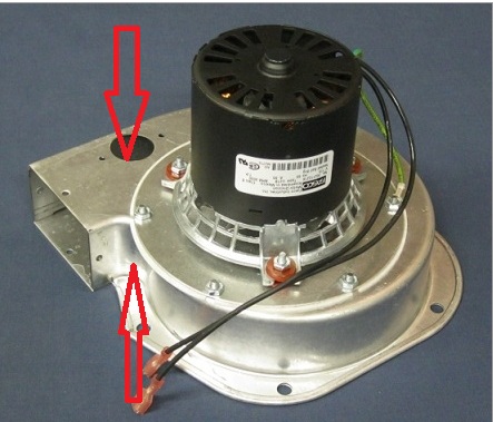

    Jay, do you know if just the Fasco motor can be bought?
    The dealer tells me it comes with the big metal housing which I don't need, not trying to be cheap here but......
    I think my current impeller has 9 blades.

  13. Geek
    Geek
    Oct 10, 2015
    262
    601
    06770
    I was referring to the big metal housing, see red arrows in the picture attached.
    I thought I could just buy that motor which comes with the impeller mounted without the big metal housing. Removing the big metal housing would mean having to caulk that piece of pipe where you connect the appliance adapter, looking at that connection it also has some screws and one is behind which could be a PIA to remove.
    I may sound to be complicating things more than what they are, but just making sure of my best option and just be done with it.
    This Fasco motor is mounted on its plate with 3 ears/screws, and its plate is mounted on the big metal housing by 6 screws. I think the diameter of that plate is 6".
    The Harman motor you mentioned I assume is the one we were talking about before that is 11-blade and rated at 1.75A that can be bought for $1oo at GA? If not, which one specifically, can you post a link please?

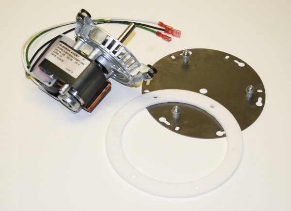

  14. jtakeman
    12,310
    55,497
    Ohh OK, I though you were referring the the round metal plate. I wouldn't remove the metal enclosure from your stove unless it was damaged......
    This is what I usually see. Just the round plate and the gasket.
    Also note its a c frame motor, Where the one you pictured is a TEFC.
    The one pictured is available on ebay for around the same cost as the Gleason you are looking at. I would ask them if its a c frame??
    Geek likes this.
  15. Geek
    Geek
    Oct 10, 2015
    262
    601
    06770
    Right.
    I think I am getting to understand this better now. In summary, it does sound as the c frame motor, like the ones used by Harman in your picture is really a much better motor, hands down. Since I want to replace the motor anyway, I think that instead of buying the same motor I have shown in my picture, I will opt for the one in your picture from Gleason Avery, and I think mounting it should not be a problem in your other post, out the old Fasco and in the new Gleason Avery.
    Thanks again...!!
