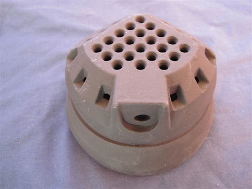

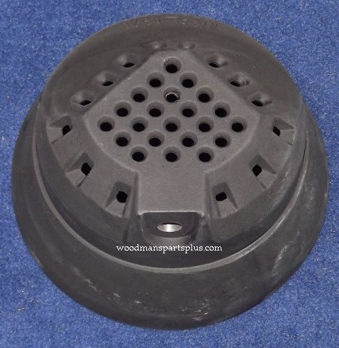

    I don't see one, I do see a steel version and a cast version. Both have the same design as yours. Cast is a smidge cheaper.
    Steel
    Cast
    imacman and Geek like this.
