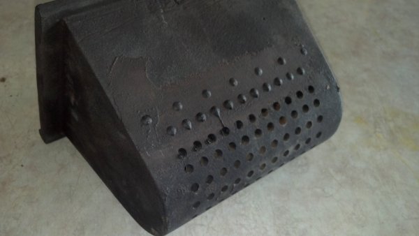

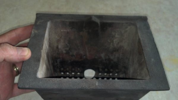

    We ended up plugging that entire 3rd row that wasn't plugged yet. Pics only show 3 rows plugged.
    That stove burned like a champ after that.
    Granted Magnum came out with an upgraded combustion blower and impeller to overcome the burn issues. My buddy just modded his pot to accommodate airflow.
    The more air you get "under" the pellets? The better! :)

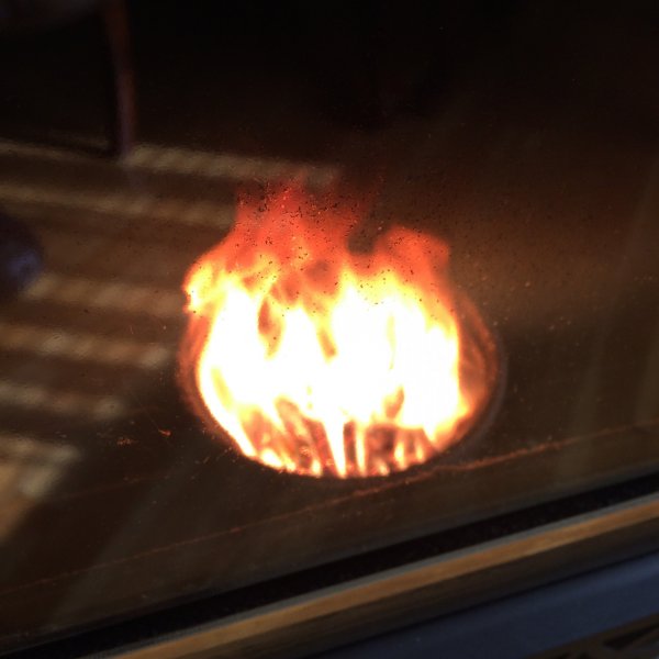

    Just wanted to show you how the burn pot looks like after running stove for 12 hours, unburned pellets bunching to the top and flame lazy as hell...can you feel my frustration?? :mad::hair::hair:

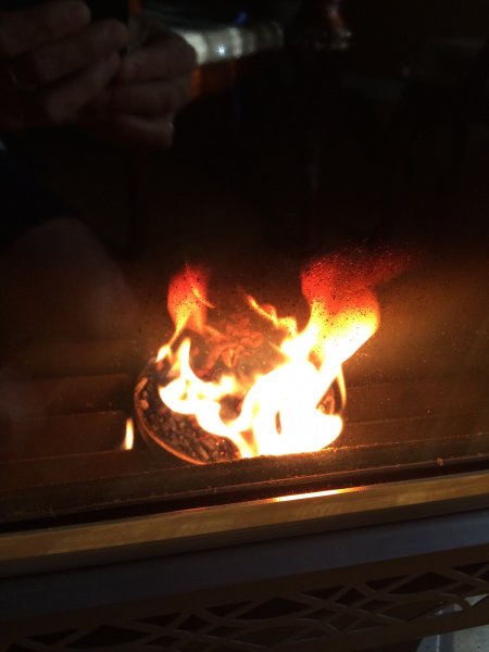

    Cleaned the burn pot, here's how vibrant is the flame with air flow, nice flame. I'm burning good pellets so no clinkers when I cleaned it but seemed like pellets not burned completely, hence the bunch up..

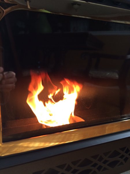

    Geek...when your stove is on high does it look like this?

    Up the heat to 4 and flame has like an orange tail and to me is dispersed or lazy? Not uniform all the way up like in the video.

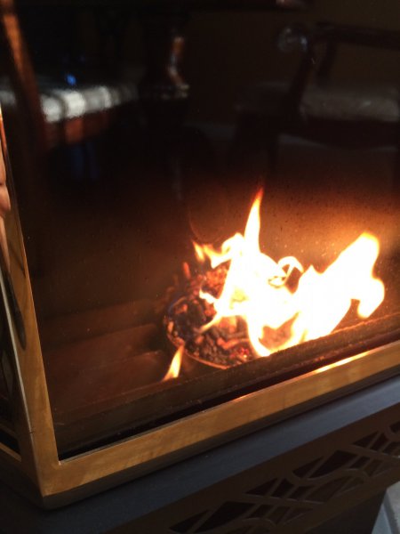

    Picture attached, note that the upper side of glass is dirty but you can see the flame.
    I cleaned glass Friday night.
