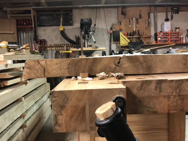

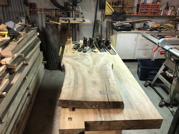

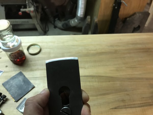

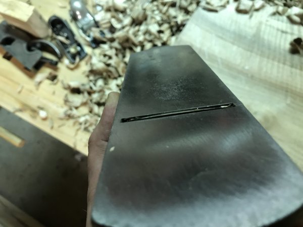

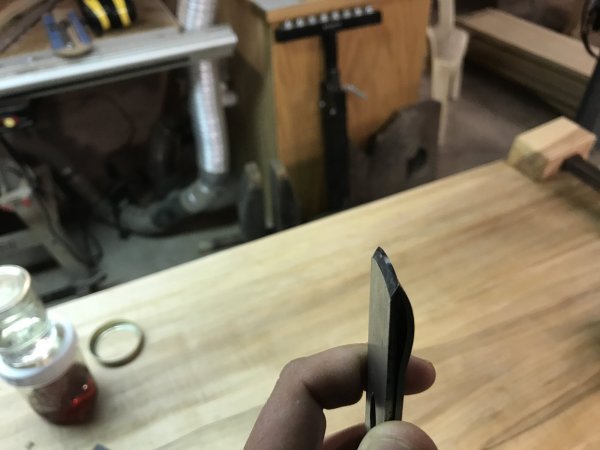

    I started planing the second slab last night. This one has a pretty significant twist to it so I'll probably need to remove 1/2" or more of the thickness to flatten it. That's quite a lot to hog off by hand so it's best to start with a "scrub plane" set to take an aggressive shaving.
    Mine is simply a #4 smoother, with a 6.5" radius camber ground into the iron. I also moved the frog back almost as far as it would go in order to open up the throat for the thicker shavings. The radiused profile of the iron allows it to make a shearing cut in almost any direction.
    So I first determine where the high spots are and focus my efforts there. I don't bother with winding sticks or straight edges for this - I rely and my eyes and hands. As long as it looks and feels flat that's good enough for me. I marked out the high areas with x's for the pic but again I don't usually bother with that.

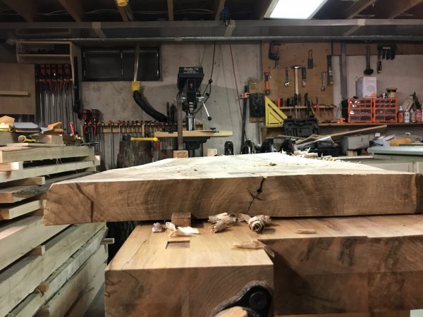

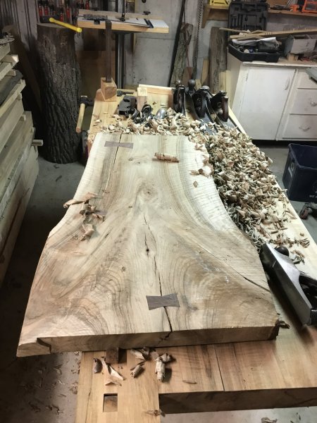

    This was about 15 minutes in. There's a bit more flattening to do on the far corner but it's getting there. Most of the milling marks from the chainsaw are gone as well.
    This certainly isn't the easiest or fastest method for planing lumber, but it's probably one of the cheapest and there are no restrictions in terms of the size of the lumber.

    Shawn, do you ever use hand scrapers for the final "cut"?

    Yes, that's the final step. Good job papadave you go to the head of the class. :D I use a card scraper to remove any leftover track marks from the hand planes. I find even with cambered corners on my iron and a very fine setting on the plane, I can still feel track marks after I'm "done", even if I can't see them. Another minute or two with a sharp scraper takes care of that.

    Did you get any tear out with the grain going in different directions?
    Eric VW, papadave and Shawn Curry like this.
  13. Shawn Curry
    Shawn Curry
    Jul 31, 2014
    3,755
    22,702
    Western NY
    Not very much this time, but I was already familiar with the grain direction(s) after the first slab. It's pretty wild - it pretty much starts at the knot in the center and radiates out towards the edges from there. I'd hate to try sending it thru a machine.
    I forgot to touch on that subject but it is very important as you would discover rather quickly. At this stage though, a little tear out can be a good thing, because it's helping you to discover the grain direction, which was not all that obvious in a piece like this.
