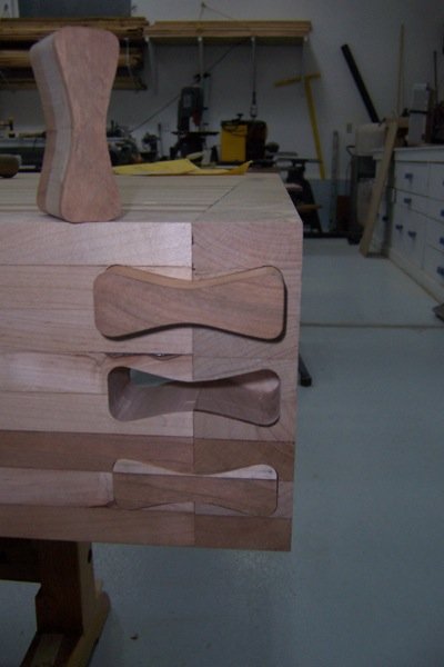

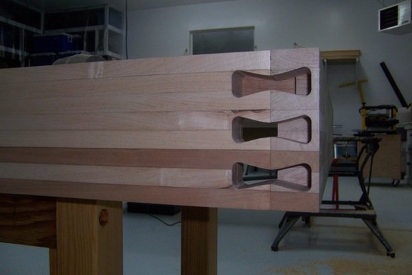

    Davetail keys:

    Ah, they're keys. Doh!
    Where's the slap head smiley?
    Nice touch.

    Front side both sides of the keys are glued in
    The back, only one side is glued in solid, so one side can slide
    as the wood expands & contracts due to MC
