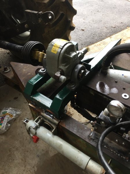

    Some updates: I finished the PTO pump mount and made a mount for the Flow control valve. Just need to get some new hoses made/plumbed in.

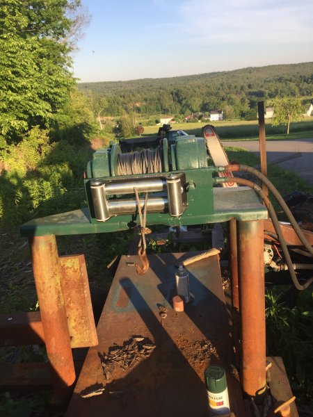

    Another update. I made a heavy mounting plate for the winch with a fairlead on it. The PO had welded some re-bar to help guide the cable in...:whistle:
    Before:
    After:
    I ran it last night after work for the first time since I made the pump mount and added the fairlead. I ran six 12' to 20' logs through it in 45 minutes. No speed record for sure, but on the plus side I never had to lift anything heavier than the winch cable, I wasn't all sweaty or tired at all! I think I can gain speed with experience and a few more improvements:
    1. I want to re-locate the winch button near the winch itself or convert it to a wireless remote. Right now the button is near the operator's location, but this requires that you walk around the machine, play cable out, hook up the log, walk around the machine, actuate the button to winch the log in, walk around the machine, unhook the cable, then walk around again to begin processing. Moving the switch would eliminate two trips per log.
    2. I need to find a way to release the winch into free spool easier. Right now once the log is winched up the tension on the cable is so tight I need to use a hammer to knock the release lever into free mode. Maybe lubing the drive lug/hub will help? It would be much faster if it worked the same way my 3-point logging winch operated. Any suggestions here would be appreciated!
    3. I need to add a cable hook and/or a spot to keep a Peavey near the winch end. I had a couple of logs I processed last night that I struggled to get the cable under/around.
    Photo from last night:

    The new mount looks a lot better. Would a set of log tongs speed things up? What about a choker chain with a rod on it to help get it under the log?
  12. Deer Meadow Farm
    Deer Meadow Farm
    Nov 3, 2015
    681
    3,433
    Warren, MA
    Tongs actually sound interesting and I have a set I could try! That might help with my winch release being so tough as well.... :thumbs:

    What size pump are you using?
    Eric VW likes this.
  19. Eric VW
    24,535
    141,452
    I don't know jack about hydraulics, but could you put some type of bypass where those two lines are, that when actuated would take fluid away from the winch, letting it recirc?
    Just thinking with my thumbs on the iPad....
    :D
    94BULLITT likes this.
  20. Deer Meadow Farm
    Deer Meadow Farm
    Nov 3, 2015
    681
    3,433
    Warren, MA
    It's a Prince; 21GPM
    Eric VW likes this.
