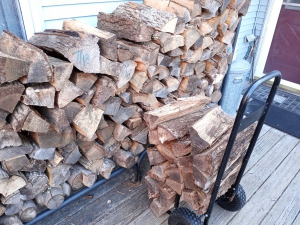

    While I haven't used a MM on it, I'm thinking that I'm ok with the stack of red oak I'm moving to the deck rack.
    I came to the level where this was.
    After moving that one more load, friends came together on the stack....if only for a short while.
    With the blizzard/nor'easter targeting us this Saturday, I'll be bringing more of that 3+ year old red oak to the house. We'll be toasty.

    Looks nice Mike!

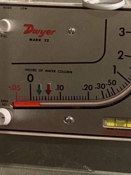

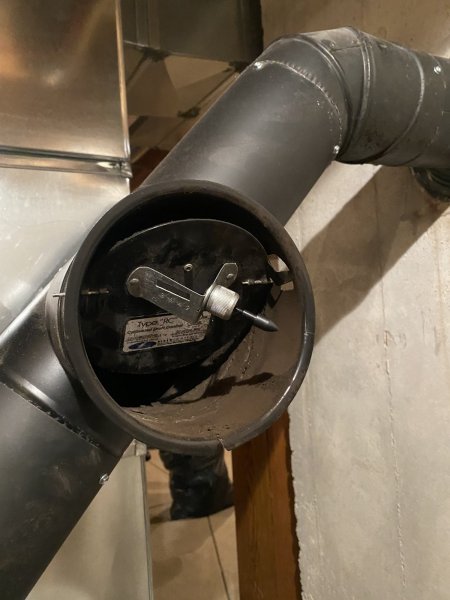

    So I added a 125grain field point into the weight for my baro damper. I has it holding at .03" on a low fuel load and a larger fuel load. Hopefully this will keep me from overtemping.
    I was looking at bringing in some wood from the outdoor pile, but its 5 degrees right now and the tractor wont start. This weekend it will be up to the 30's. I can fill the basement then.

    Can you build a bigger chute? I put the biggest pieces in I can…..which likely have some moisture. I just choke the damper down and ensure the barometric is free.
