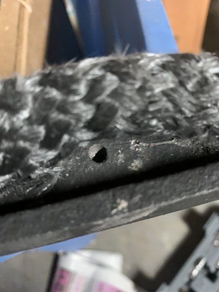

    So instead of throwing it out I plan to do something like a shadow box or picture frame or something. It was raining and raw yesterday after work so I went about re installing the glass. It looks to me like the threads pulled out of the cast door? I would expect to see clean threads right to the surface of the cast?. B97E93A7-0193-4861-A03B-D56C46D71266.jpeg 78E2C5B8-E518-4E8B-9F90-893DF4C8C4DF.jpeg I can get the machine screw to bite but not until it’s way into the bolt hole. interesting

    I see 'guide holes' in a lot of the cast aluminum parts we use here. It must be to help assembly. (There are ss heli-inserts in the aluminum for the ss bolts.) With aluminum, 'stepped in' also probably helps with corrosion from the dissimilarity of metals .

    I’m not familiar with “guide holes”. Perhaps it’s a thing. I could remove one of the fasteners on the new door for inspection. I might just do that even tho I have no plan to use the stove again.

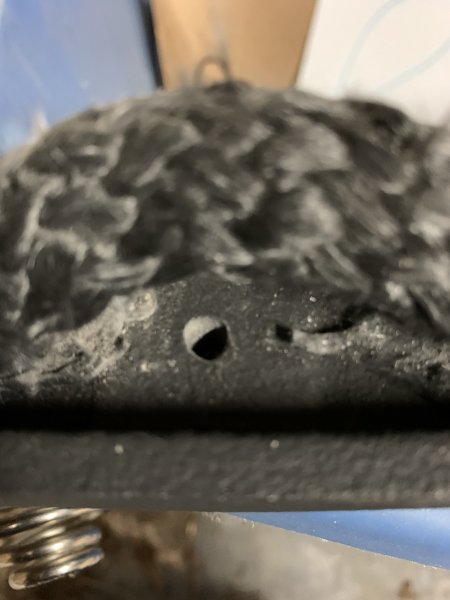

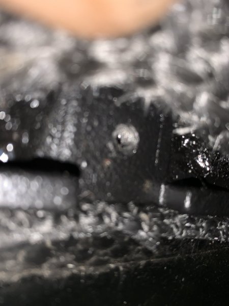

    0E4257EA-3A5A-4B93-8B31-DBDD56DA78B6.jpeg Sorry for the terrible pic it’s the best I could get. There are threads through the entire bolt hole but it appears it was tapped sloppy or the fastener was over torqued pulling some of them. My thought is the heat cool process worked fastener out of the cast door.

    Yeah, hard to see. Is it a tapped hole or an insert ?

    It’s tapped.

    Bad or soft castings maybe? Who knows. Doesn't look right for sure. Are you going to fire the stove back up and try the new door, or sell it?

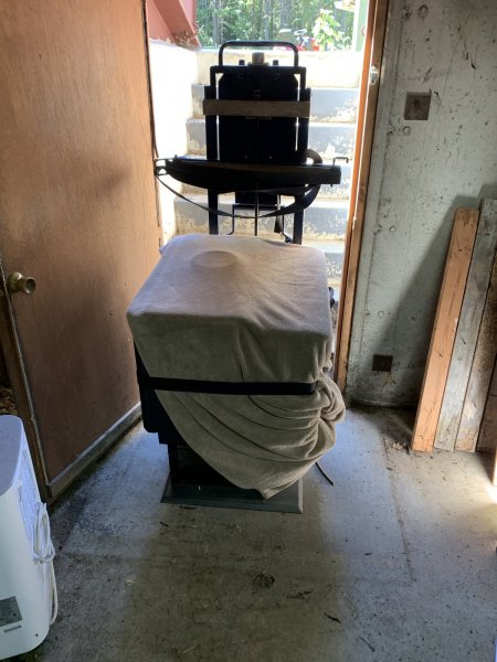

    469DFF23-B55A-4FA7-9490-4FAA2A2E3FB1.jpeg Stair climbing dolly is a back saver for sure. The stove is in the garage I’ll clean it up today and list it. I plan to disclose there was an issue with the door but it was replaced under warranty.
