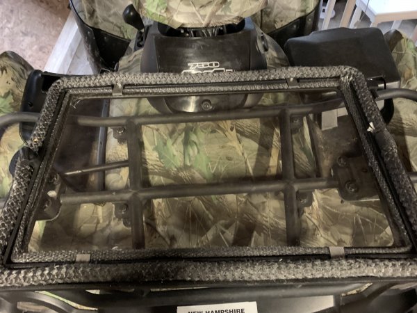

    D374699D-49DD-47FE-8C33-10858B34F78E.jpeg New door arrived.
  12. fishingpol
    fishingpol
    6,502
    39,646
    Merrimack Valley, Ma.
    Have you had a chance to compare the two doors/clips?
    I'm curious if anything is different.

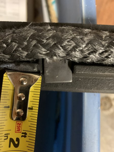

    Original failed door 9D8C3888-F0E0-41CC-A74E-60D4D90415D3.jpeg new door 9731A107-2B13-42E6-85AD-F48A53F97DFD.jpeg
  18. fishingpol
    fishingpol
    6,502
    39,646
    Quite a difference there...
  19. bushpilot
    bushpilot
    Feb 25, 2015
    3,240
    14,366
    Eastern Washington
    It looks like they corrected it.

  20. billb3
    10,513
    54,567
    That should be long enough now. I'd be tempted to make even longer ones even though they would be visible through the glass. So what. I'm surprised they don't send just the longer clips/retainers.
