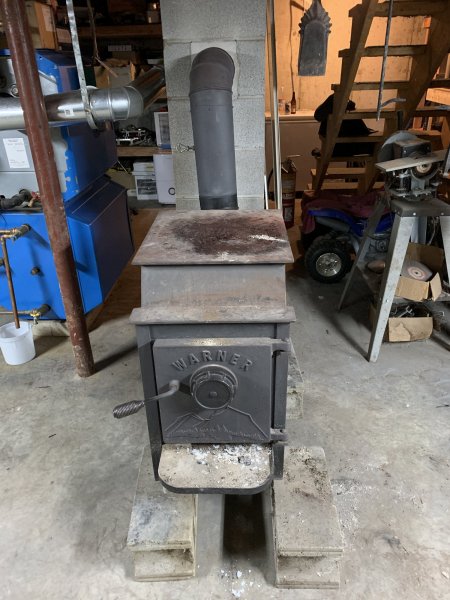

    0552B66F-E326-419F-B403-EE35AF49052A.jpeg She’s back!

    Out with the bold and on with the old!!!

    That was quick...you have that thing on skate's? :rofl: :lol:

    It moves around quite nice on a floor jack!
