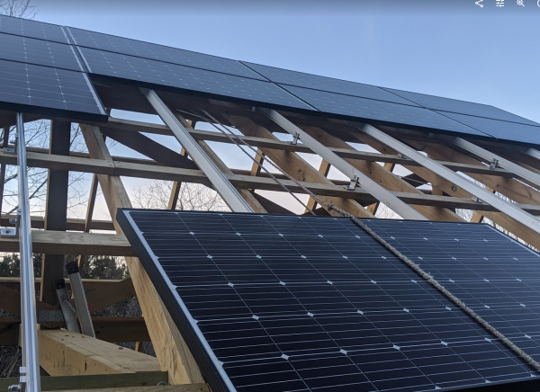

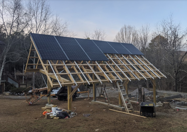

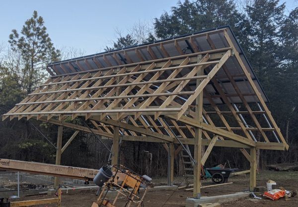

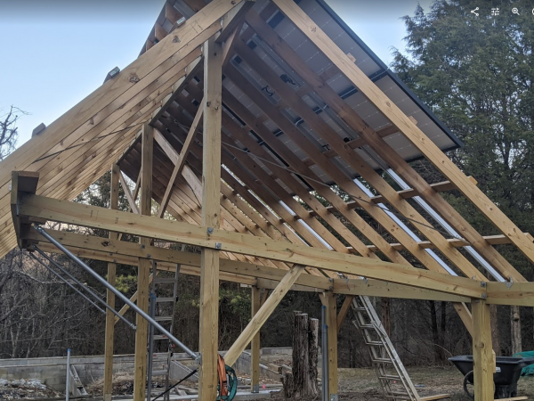

    The weather has slowed progress a lot. I hate mud...and mud over frozen ground is downright dangerous. Some update photos to share:
    Looking north, 15 panels mounted.
    Panel mounting details.
    The structure looking southwest.
    The structure looking east.

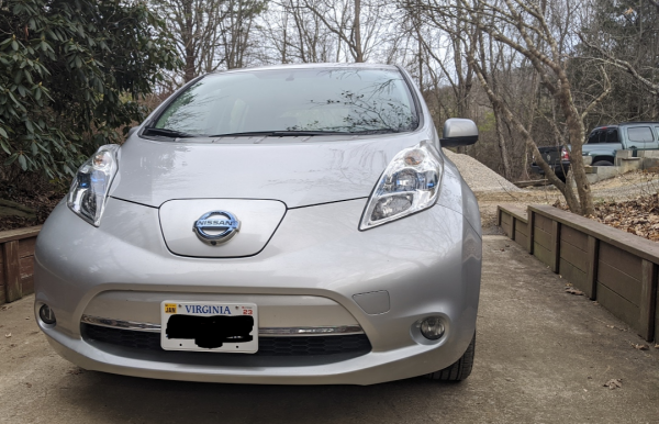

    The EV I bought to park inside and fuel with sunshine.

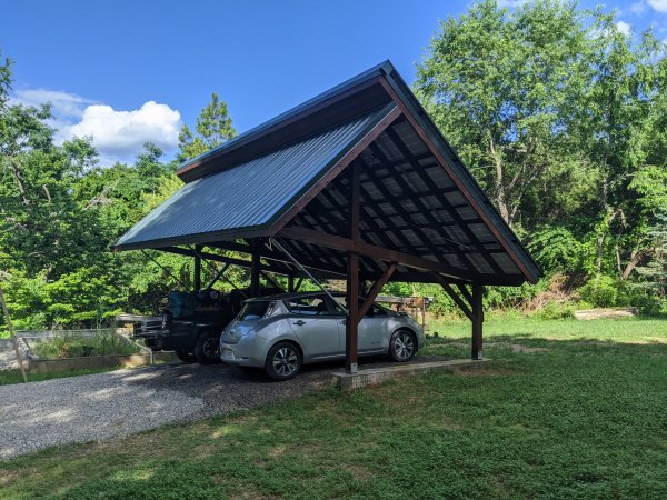

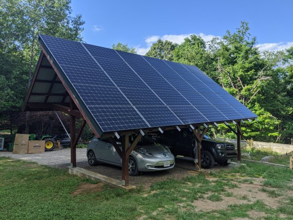

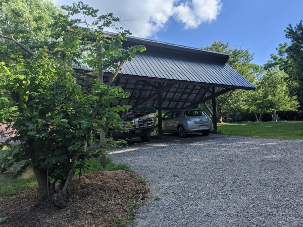

    I haven't been good about posting updates but I have finally gotten the project finished except for the backup batteries.
    I thought I'd share a few photos.
    Production has been great. We're making more than we're using and building up a balance for winter use via net metering.

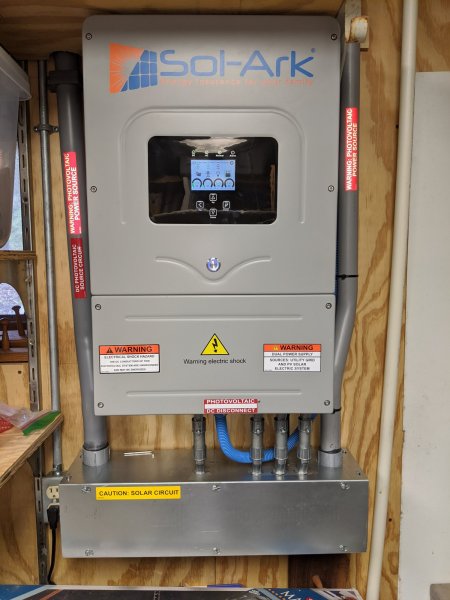

    We're averaging about 36 kWh/day or 1,125/month.

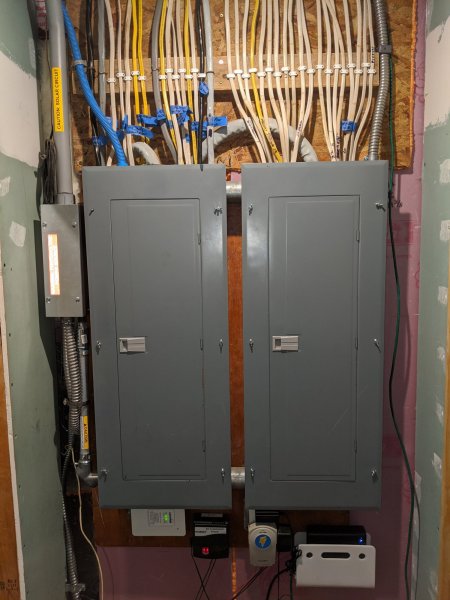

    A few more photos: the inverter/charger on the left and the breaker boxes on the right. The right panel is the backup panel.
    I have many more photos if someone wants to see any specific details.
