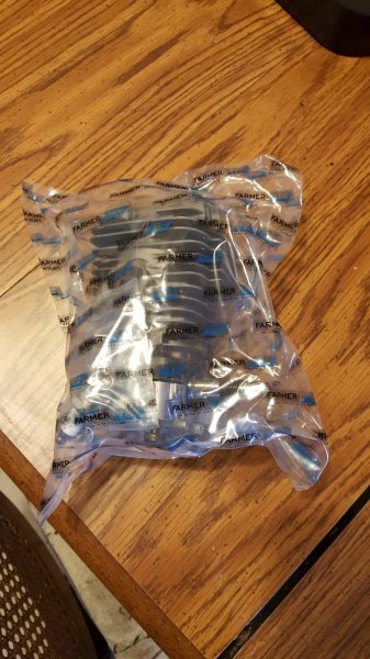

    Ya the new motor is aftermarket, bought it off ebay, but it is a brand new product. uploadfromtaptalk1449612706140.jpg it is not sealed up, but it is all assembled, I will just need to seal the crankcase when I put it in.

  9. Allen Lee
    Allen Lee
    Nov 28, 2015
    102
    308
    California
    It's farmertec from china. So you have had good luck with them?
