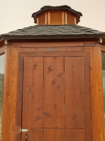

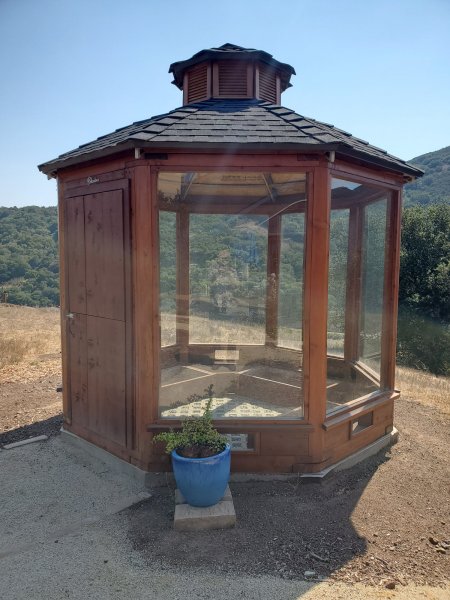

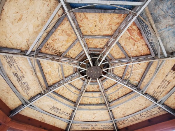

    I see that it has been almost 4 years since I updated the Belvedere project. The good new is that it was completed 2 years ago. The not so good news is that I never got to enjoy it. I left it behind in California when I moved home to Illinois post divorce. (more on that in a more appropriate area...)
    So, here it is, with the cupola. But I brought the copper weather vane I made with me to Illinois. I paid some contractors to finish it while they were repairing the house. It's not quite the way I would have done it, but that's OK.
    The Belvedere emblem is from Ebay from a 59 Plymouth.
