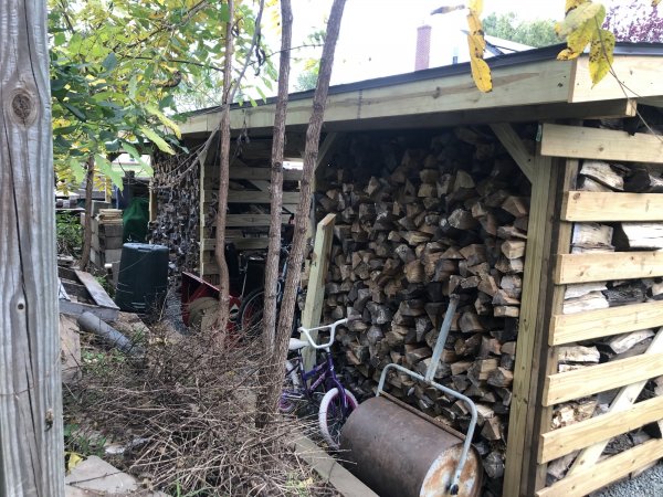

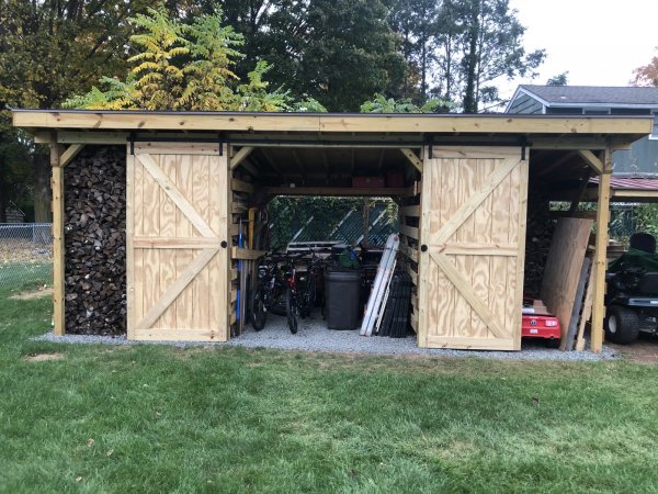

    Took some pics when I got home today. One of the rear of the shed and one with the doors open.

    Looks like sumac growing behind the shed. You live near a marsh ?
  12. saewoody
    saewoody
    Oct 11, 2017
    617
    4,266
    Central CT
    It’s funny you say that because I thought it was sumac too at first. But then my son pointed out that the leaves were the same as the trees in the neighbors back yard. He said that tree drops some kind of nut. He was well aware because he’s been mowing their lawn for 2-3 years. He believed they were walnuts. So having no idea what walnut leaves actually looked like I looked up walnut tree leaves. They appeared to match. And when I looked at the bark closer, it wasn’t like all the sumac we had around when I was growing up.
    So I think they are walnut saplings. I can’t really let them get to big because they have sprouted up on a small bank behind the shed. But for now they provide a little something. I’m not really sure what that something is yet though.

    Great build! I like the center bay storage concept. Sliders rather than swing doors was the right way to go. The actual door construction looks very nice!
