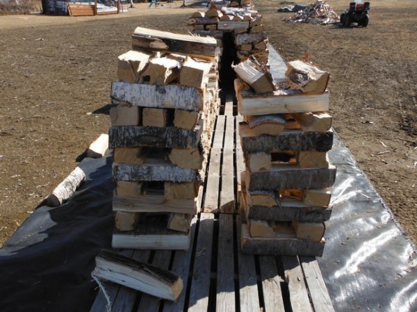

    It starts with the splitting, making some square or rectangle splits for cross stacking the ends.
    Build the cross stacked end & have them lean into the stack & toward the other row.
    Then when they touch, they support each other & keep snow out of the middle. Allowsfor good air circulation too.

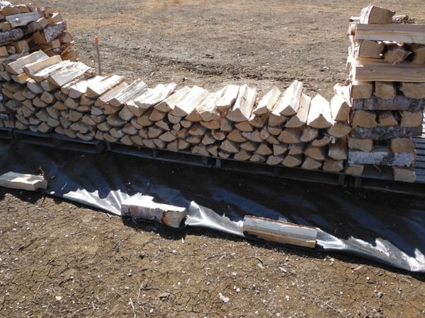

    Here's a couple pics of the ends.
    Stack the 2 rows with a slight lean toward the middle so they join a few splits from the top.
    Then I stack bark up for a rain, snow roof & overlap a 1/2 split down the center line.

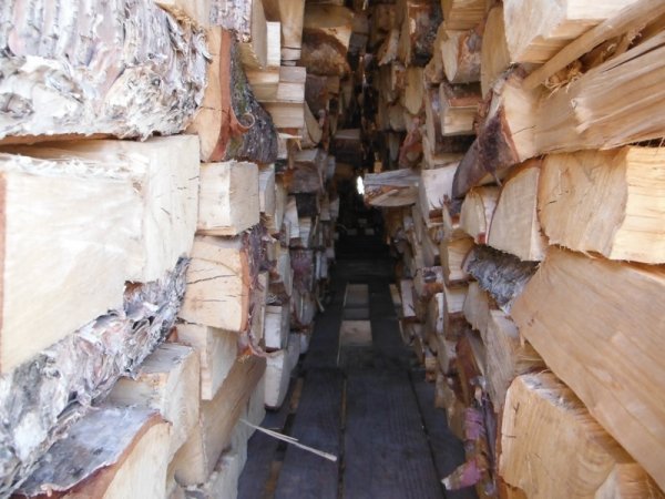

    Pic looking down the middle of the 70' long stack (our cat like to walk thru it )
    Some pics of the sunny days stacking :

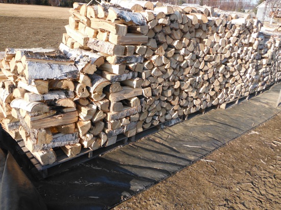

  2. bogydave
    Couple more pics, need the mts in a couple :)
    Noticeably heavier wood than I handled all winter going into the stove.
    I loose stack with lots of air space between splits.
    Another 12' section of the big long stack done.
    Measure to 1-1/4 cord , but a good full cord when it goes to the shed
    after drying, shrinking & I'll stack it tighter.
