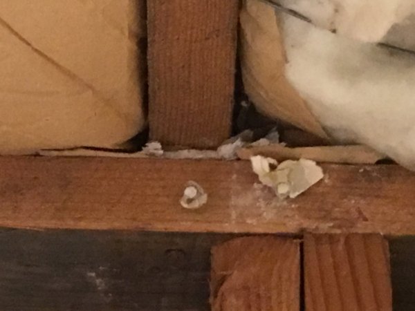

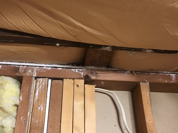

    Question for you guys that have been doing this stuff awhile.....
    Is it common/acceptable practice to build partition walls (non-bearing) without removing the drywall on the ceiling above? I know these are non-bearing but still...... seems like you create headaches for the next guy..... especially if you need/want to change the drywall thickness.
    One more for you guys, when the dining room/master bedroom addition was added on, the ceiling joists are just toenailed to what used to be the exterior wall of the house, which explains why the ceiling height is slightly lower in those rooms. (Top of the joists are slightly above the plate of the wall.)
    Doesn't seem all that strong to me, maybe joist hangers were not common back when that part of the house was built? (1970s I think.). Nothing over it other than the roof, but the Mrs and I have discussed a 2nd story addition and I think this would have to be remedied before that could happen.
  13. yooperdave
    35,619
    223,664
    Adding a second story? Better make sure the first story is O K to handle it.
    Judging on what you have found so far......well.....you know.
