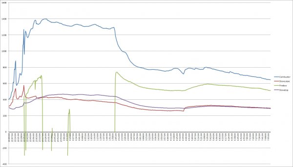

    Therein lies the rub, it is not how long the stove 'burns' but how long it puts out what amount of heat. It is not a problem to get an Ideal Steel (or similar, modern, combustor- based woodstove) to burn for 12, 16 even 20+ hours. The problem is how much heat the stove can put out for what part of the burn.
    This is a typical, overnight, hard (Easy Boys!) burn for me using hardwood in an IS.
    The stove reload is around 10:00 PM (2200 on the chart shown) and the combustor is very well engaged and burning off the volatile gasses for about 4 hours. After that, the rest of the wood / charcoal continues to burn pretty steadily until the end of the chart, which clearly shows the stovetop temp. dropping below 400F but remains pretty steady, at or just above 300F, until 8:00 AM the next morning. So that would be a 10 hour burn and the stove's heat output was sufficient to keep up with my house with the outside temp. being 6 F in the morning. I find this typical behavior for a well- packed IS full of <reasonably> dry oak. By well- packed, I mean just moving the coals around and shoving splits in the stove until I could not fit anymore but nothing special such as filling all the air pockets in the stove, picking through a big pile of splits to find just the right one, etc. Just plain' ole' filling the stove up and letting it run at a little less than 1/4 draft. That was mostly a 'cat burn' with few visible flames; note that the firebox temp. (when the thermocouple worked :-( ) shows the temperature in the firebox was well under 1,000F, indicating a smoldering fire.
    In the end, the key to heating with firewood in any stove is about having control of the burn, having the stove burn cleanly and efficiently (which is where cat. and hybrid stoves excel) and the size of the firebox. As long as you use fairly dense, dry hardwoods such as oak, hard maple, etc., the stove should easily be able to maintain a stovetop temp. of 300F for an 8 hour burn.
    I cannot even guess at what you might need to heat anything like a yurt though- no experience with those so I have no idea if the Ideal Steel is enough stove or not. ?? But if it is not enough stove, the only way I can see to really improve the situation is a larger stove as there are not many, if any, more efficient than an IS in my limited testing.

    So, here's my thought. What if we could get that cat to peak out and hold at 1000 degrees instead of 1400? I think we are all looking for a long even burn. I wonder how much the secondary air feed effects cat temperature.

    Not sure how the methodology would work out regarding numbers but I agree with the general sentiment. Also, I believe these stoves (the Ideal Steels) need more bottom draft, either from increased hole sizes in the angle steel in the front or through the grate at the bottom. But in the end, yep, I agree that an outside control would be of significant benefit. I was working on same when I had a small set back regarding my house (structural roof failure and ins. co. hijinks) and two fingers (mangled in an entirely self- caused wood splitting incident). I will again re- visit this issue but it may be some time yet.... I am still typing slowly due to right hand index finger lagging :-( Still, not complaining 'cause I could have just as easily lost one or two digits so really, in a left- handed way- I am lucky.

    Just my opinion so take all of this for what it is worth..... I do not think we can actually restrict the temperature of the cat. burn, at least not directly. The cat. simply burns whatever fuel (smoke) it is fed provided it gets sufficient oxygen to do so, and we certainly do not want to restrict that as it would simply have the cat burning some amount of smoke and the rest going up the chimney.
    What dictates how much heat the cat. puts out is the amount of smoke the wood below it is feeding it. In a pure cat. burn, the wood below just pyrolyses, meaning it basically smolders without producing any flame, much like a cigarette. And that is the problem with throttling a large load of firewood, especially if it is a fresh re-load. The wood has to be hot enough to pyrolyse and throttling that too far back will basically 'put out the fire' in the firewood, as well as shutting down the catalyst. To get the whole thing going again, the fuel usually has to be heated up well beyond where it would just maintain a slow burn and basically produce more heat than desirable until it can again be throttled back to some minimum burn rate. The only way around this restriction that I know of is to externally heat the combustor, which of course takes additional, outside energy and that kind of defeats the whole purpose of heating economically with firewood in the first place.
    All of that said, I have had some success relaoding an IS and immediately shutting it down to 'idle' status as another poster mentioned. But it only seems to work when the bed of coals in the stove is a pretty large amount compared with the amount of fresh wood being loaded- in other words, it does not seem to work when the stove is, say, 90% empty. But if there is, again say, a 40% intact coal bed, then filling the rest of the stove seems to allow the process to keep going without the whole high burn rate needed. But that also makes the the stove behave as if it is much, much smaller and it cannot go well overnight like that because it was only loaded to 60% capacity with fresh splits to start with.
    This whole wood burning thingy is a tricky business if we try to regulate it closely and restrict how it burns. That is where a much smaller load of wood, burning 100% all the time is much more efficient.... those are called pellet stoves. :)
