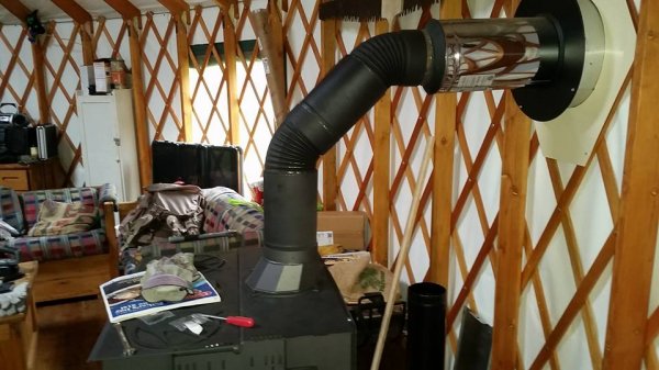

    Very cool Jafo! Good luck with it! What kind of wood were you burning, and how big are the splits?
    YIKES!
    Me too!! Looks like the thingy's I see them living in on the beach in Alaska on the Ice Cold Gold show....
    It pulls the combustion air from outside thru the OAK, instead of using good heated air from your home (or, YURT!). So in other words you loose less heated air in the living space going up the chimney.

    How warm does the shell of the yurt behind the stove get? Since the shell is so thin would it save heat if you put a reflective panel there to re-direct that heat back into the living space?

    I have the heat shield, so there is really no heat emanating from the back of the stove that touches the wall. The wall itself is about 2 feet from the stove. The yurt is insulated with refletix insulation all over the shell.

    I didn't see any mention of OAK for the IS on their website. Is the port provided and you just hook it up, or did you have to have an adapter or something? Not sure if I want to cut a hole through the wall/floor in my somewhat temporary setup, but at least the option for a future home would be nice.

    The adapter is already mounted to it when you order it. You just have to supply the pipe.

    Just an update. I have replaced the first 90 bend with two 45s in hopes for a better draft:

    Do you have any concerns about using single wall stove pipe from the stove to the class A?

    No. I have always used it. I did get some pretty beefy 45's for the job though.
