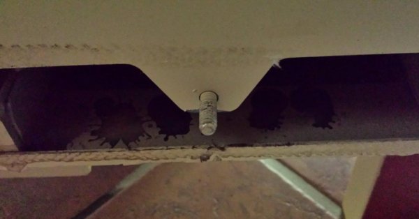

    The plot thickens....I removed as much of the back panel as possible and found some interesting things. Let's start with a pile of metal filings below the butterfly valve; how they got there is a mystery because they are on top of the paint.
    Next up is a top view of the port with the cover removed. Notice the creosote splatters:
    Last but not least, and close-up view inside the port. Notice the creosote dripping down:
    This is as far as I was able to disassemble. To be blunt as a bowling ball, I'm starting to think that this stove is a misfire in the production run.
  6. papadave
    Is this the side of the stove that got "forked"?
    Could be something got bent when that happened, even if it didn't take a direct hit.
    That is definitely not good.
    Can you get a flashlight and look up in there? Use a mirror. :sherlock:
    A lemon is also a possibility.
    I'd wanna' know where those drips are coming from, as I'm sure you are.
    wildwest, concretegrazer and BrianK like this.
  7. BrianK
    BrianK
    3,108
    11,115
    West central PA
    I'd have to wonder if the forklift incident broke a wield in the firebox somewhere, letting the creosote condense and drip down because of cool air introduced by the break?
    wildwest, concretegrazer and papadave like this.
  8. BDF
    BDF
    Jul 22, 2014
    2,160
    7,533
    Virginia
    Great photos and great information.
    It looks like the creosote, at least a good deal of it, is coming from the secondary air intake rather than the primary. I would think but of course do not know, that the secondary air feed would be sealed all the way to the top of the firebox where it is introduced behind / over the stainless steel, perforated firebox top. Nothing there should be dripping creosote, again in my opinion.
    Also, you may well be right in that there was a defect during manufacturer- hey, it happens. Maybe a seam was not welded, maybe a corner was not sealed or something similar.
    So now I would suggest taking the next step and sending this information to Woodstock and further, call them on the telephone and speak to someone about it. At least give them a chance to make this right, and I bet they will do so. I understand you contacted them before but we live in an imperfect world and perhaps your problem slipped through the proverbial cracks.... ? Contacting them again will cost you nothing and take very little of your time- you already did the time consuming part by documenting the problem very well, just a few more minutes of effort on your part and I think this whole issue may be resolved to everyone's satisfaction.
    All in my personal opinion of course. And the very best of luck whichever way you go.
    Brian

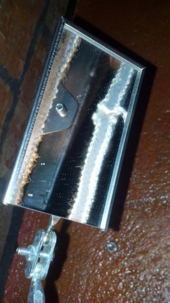

  13. Gark
    Gark
    1,312
    4,550
    SW Michigan
    To offer more data, this picture shows no creo drips or drops behind the single-bolt plate on our stove. We've burned about 2 cords (18% MC) and burn cat only mode mostly.
    fox9988, milleo, wildwest and 2 others like this.
  14. papadave
    Gark, is that a gasket, or a weld?
    wildwest likes this.
  15. BrianK
    BrianK
    3,108
    11,115
    West central PA
    golf66 Same here, no creosote drips/drops behind the plate on our stove, so it looks like it might be a bad weld or other manufacturing defect or forklift damage inside your unit, not a problem common to the IS stove design itself (judging by Gark and my photos so far).
