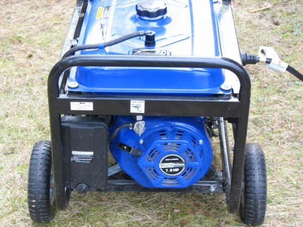

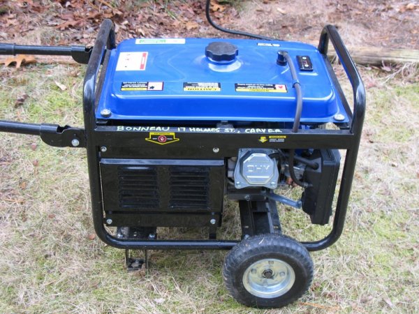

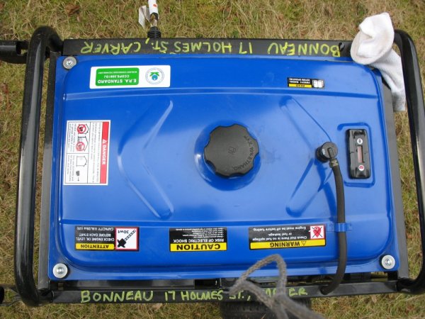

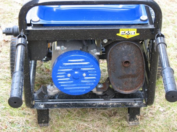

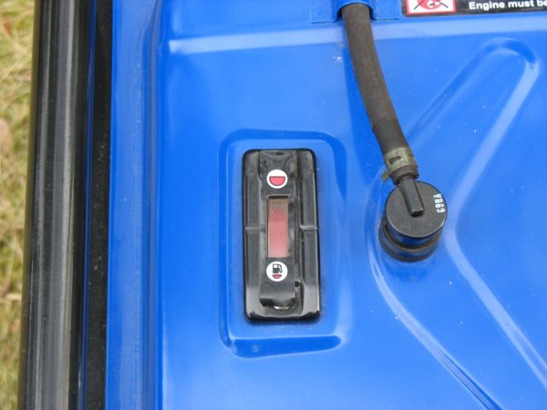

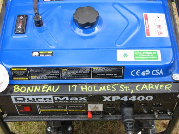

    Took some pics when I set up my generator for it's 4 week run/test. Thought I'd share some pics to show my setup to see how I set this up.. Ran just the furnace for hot water and the well for water while the spouse took her shower to give some load. Note the large muffler this generator uses.. Can hardly hear it in the house with the windows closed! It hiccups but recovers especially when the 1/2 HP well kicks on but worked fine.. :thumbs:

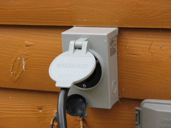

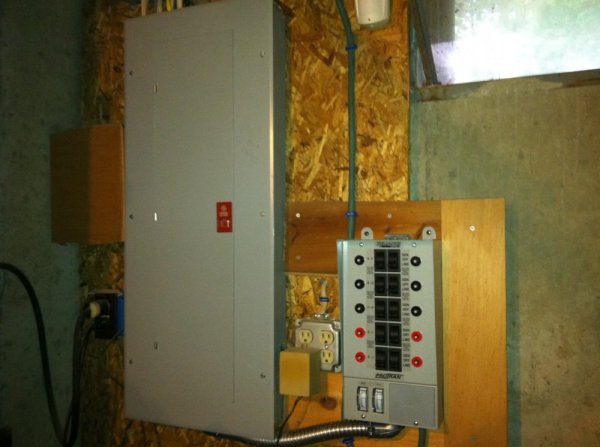

    Here is what is where that outside plug connects to in the cellar.. I simply flip the top right and left switches on the transfer switch and voila I am running the well and furnace on the genny.. Doesn't get any easier than this! Yes it's a bit of work but when it is done it is done and easy from that point onward.. :smoke:

    I really like the power meters on the generator panel, makes balancing the load on the genny much easier and you get some idea of how much total load is on the unit. That's something my setup lacks.

    Yes that's helpful to see what sort of load you're dealing with..

    I'm a licensed electrician and only installed this around 15 months ago lol.. Have lost power as long as a week from a hurricane and 4-5 days from a blizzard and that was the last straw! My genny is small and cheap (about $300.00 shipped) but good enough for a few basic needs.. The transfer setup ran around $350.00 plus the 10/3 to go to the outside power inlet box, maybe 6' or so..
