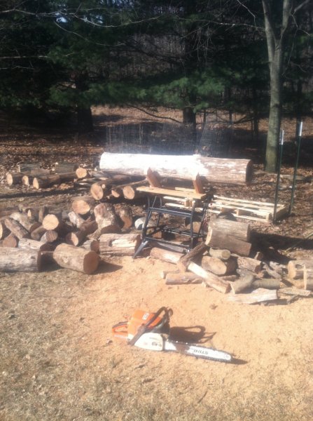

    Today I cut up some of the 5 to 6 foot pieces I hauled back with my garden cart. I wanted to try cutting from a sawbuck instead of in the woods; somehow I thought this would be easier on the back. I think this is one of those "good in theory" kind of ideas, but in practice it isn't quite so good as I am handling the logs way too much. I'm going to go see if I can locate a peavey with log stand Monday and use that to do all my cutting in the woods so I am only handing the wood once. I did make a quick sawbuck using my workmate, plans are here: http://www.instructables.com/id/Workmate-Sawbuck/

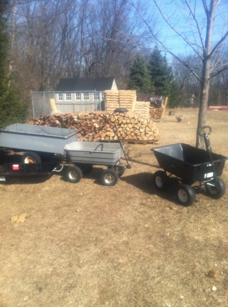

    Also added a new dump cart to my firewood tools collection; as you can see, all my equipment is the high-end stuff.

    You are still doing better then my aged plastic toboggan sled :dex:

    Yeah I cut up small polls, a whole bunch at a time on my saw buck type deal, it works out real good but the one you have up on there is, in my opinion a little large to be lifting up onto a Sawbuck.
    I tried the log jacks but didn't like them, have to reposition them too often, just cut them three quarter through, and roll them with a Cant hook

    Who makes those plastic wagons? I want one!!

    Tractor Supply has them for about 99 bucks. Gorilla brand I think? Have one myself and like it a lot Like the Kubota more though:whistle: I also tried the metal garden wagon from the big hardware joints. Ran the wheel bearing and steering couplings right off the piece of junk in two seasons.

    Yep, TSC: http://www.tractorsupply.com/en/store/groundworkreg;-heavy-duty-dump-cart-1400-lb-capacity
    It is their store brand called GroundWork and is supposed to be rated to 1400 pounds ... don't think I can get that much wood into it and if I could, don't think I could pull it. I don't know how it will hold up, but I prefer to use these to move my wood from splitting area to stacks and from stacks to garage.

    I NEED one of these! Thanks for the link. It sounds like it could even be used as a trailer behind a tractor or ATV use if driven slowly.

    HarvestMan, if you don't like the sawbuck, do yourself a favor and don't get one of those peaveys or cant hooks with a log stand. In my humble opinion, they are the most useless tool made. Someone gave me one once and it took many, many years just trying to give it away. You can use them if you like but do not expect to save any time or work. They cause extra work and some of that can be back breaking.
    If you'd like to try something simple and easy for cutting in the woods, then just get a cant hook. When you fell a tree, you'll always find spots where you can see daylight under the log. That is where I cut them off. Then simply lay down a couple of small limbs and roll the log onto the limbs. Now it is all up off the ground. Or, just simply cut through the log 3/4 of the way or more; just so you don't hit dirt. Then after making several cuts, roll the log and finish the cuts from the top.
    On the sawbuck, we almost always have one but don't always use it. We use it mostly just on the small limbs. I cut them to length depending on how heavy they will be and most of the time my wife will carry them to the sawbuck. Stack several then cut them. But I would guess about 98% of the cutting we do is like I have advised above. We cut where the tree falls then move the logs to the area we want to split and stack.

    Thanks for sharing your experience; I'm still trying to figure out what works best. I do know that cutting old downed trees results in more need for chain sharpening than I would like. Usually, I take a shovel with me and dig out under the logs in a couple places to cut them to a size that will allow me to roll them after cutting the top half. It is still a bit of a struggle to move some of them, not sure if I need a cant hook, or just a pry bar that won't bend easily. I did call some Stihl dealers and found the 48 inch log peavey was about $130 and the log stand was $45; that is a bit more than I wanted to spend.
    The sawbuck actually did work pretty good when I used it for logs of a reasonable size; for the bigger logs, I'll just cut them in the woods.

    Harvestman, I have found a cant hook is a very useful tool while in the woods. Not only can you lift logs up to cut them, but you can use it to free snagged trees when felling them.
