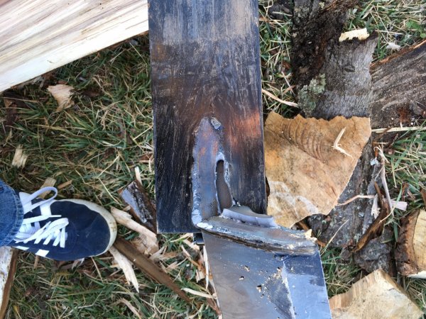

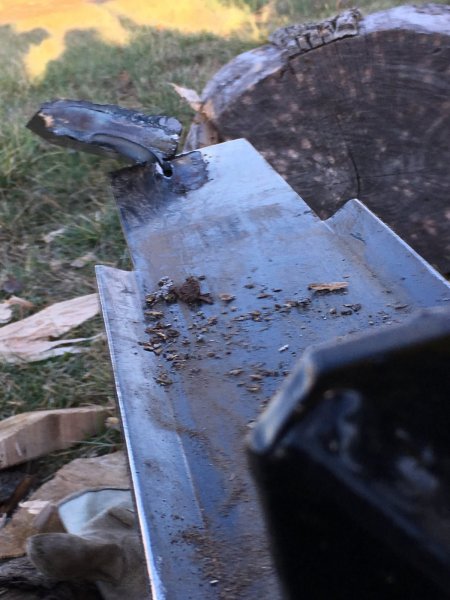

    Welp.

    Not enough penetration.... grind it all clean, weld at home, a buddy, or take to a reputable shop....
    It happens.

    Bad weld job it happens but if I were you it would go back to Sam's. I am sure they will give you a new one.
    Good thing to note is it has plenty of power.

    Yep, bad weld...under warranty...I'd exchange it and make 'em give ya a gallon of oil (at least)

    The thing I like about Eric's idea of fixing it is I'd get to keep the $30 in oil I've got in it. But man, I only have 1 hour of runtime on it, and it's 4 days old.
    I'm kinda ingnorant on hydraulics, so could I put it on the back of my truck tailgate, undo a hose, tilt it back and try to salvage some fluid with a funnel? How much do you think I'd recover of the 1.3 gallons?
    I'm on the fence whether to try another one or not. If it happens a second time, I guess I could just accept those welds are going to be bad and get a buddy to weld it up and move on. You said this happens a lot, Eric? Seems like it would be built to handle 7 tons of force no matter what, right?

    For that price I'd try to get another and have it welded if it happens again. That's a sweet lil splitter.

    I would say re-weld this one, except for the one piece that held, and is now forever deformed...PITA to deal with. Sams will take care of ya on this I bet.
    Man, that was a REALLY crappy weld! The next one has to be better...

    Do you have a Vo Tech school near by? You could take the new exchanged unit and see if they have student/s who would weld it up before you use it. Take the pics you posted here so they know what they are attempting to mitigate. At least then you wouldn't have to deal with straightening things out when they break next time. I have had them weld aluminum before with great results.
