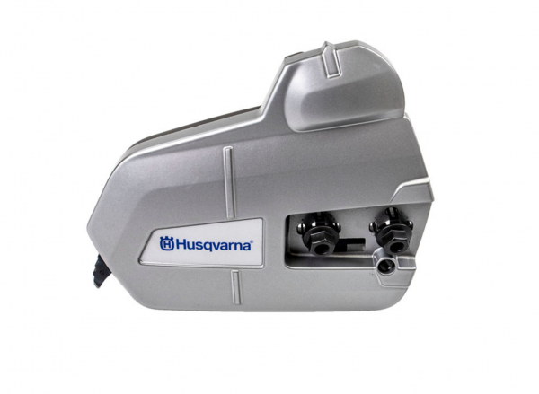

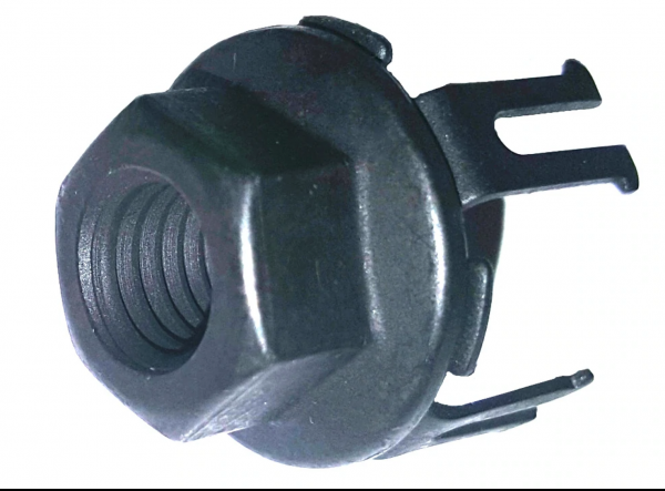

    Did you change the captive nuts so that you could put outer spikes on the clutch cover?

    Just an update. I decided to start with the easiest fix: tighten clutch cover nuts. Used the saw to take down that ash in my other post (critique my hinge), then bucked it all up. I used it for something else, though I forget. Just trying to say that I used it more than I did the last time I used it to take down a small cherry (and the chain was thrown).
    Overall, went smoothly. I kept checking chain tension from time to time and it was holding in well. I have a few more logs to buck, so will keep using it. But so far the simplest fix seems to have worked.
