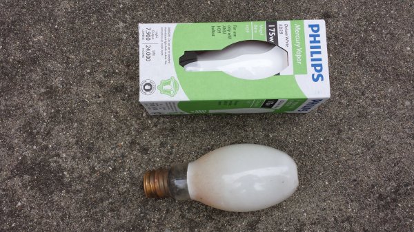

My big yard light died, fix or replace?

    Just curious, how long did you wait after covering the eye up? They can take up to 5 minutes to switch on...

    Waited a bit , then, Left new bulb in there 2-3 hrs ,eye covered up, while I was searching for a new one , no go
