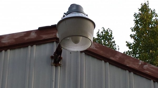

    Don't know that much about these kind of lights but this was here when I bought the house, so its at least 25 years old, it has been working fine all these years I think it is a mercury Vapor.
    There is no switch except for the breaker it is attached to, that's the only thing I've checked so far the breaker is on.
    Because this is so old I don't know if it can be fixed or not, after I check and see if it has power to it then what do I check? Is it possible the bulb has failed and I can get away with just a new bulb?
    From what I read these lights have a ballast in them also.
    If I have to go with a new fixture I don't think I want a sodium light.
    The new fixtures and looked at online a lot of them do not have very good reviews.
    What do y'all think, should I go LED, Halide, CFL?

    Very likely it is the bulb or the eye. The eye is the switch on top that senses when to turn on (light/dark) and you can change those two items in about 30 seconds, but, for the cost you can dang near buy a whole new CFL security light. Those Mercury bulbs are usually 175W and the CFLs are ~75. I replaced mine with a complete new CFL assembly for ~$30 when they were on sale at our local farm supply store (Rural King of Ohio)
    Oh, and they make CFL replacement bulbs that screw right in to your existing light...too expensive and very poor durability...fortunately mine had a "lifetime" warranty and after the hardware replaced it for me 3 or 4 times they offered me a complete refund :thumbs:

    Is there any way to tell , check, if bulb is bad ?
    Stinny likes this.
  10. brenndatomu
    25,137
    163,339
    Not easily, other than trying a new one or screw the old one into a known working fixture

    Ok, checked for power, no power till I covered the eye then, I got power
    Stinny and papadave like this.
  16. brenndatomu
    25,137
    163,339
    Probably the bulb is bad then.
    What was the voltage?
    HDRock and Stinny like this.

    Yep... worked on many of those. Try a new bulb first. If that doesn't do it... then a new unit would probably be my choice as a replacement ballast might be as much $$ as a whole unit. I like LED units these days. But, the output of those MV lights is hard to match... would have to be sure an LED would give you the lighting coverage you want. Good luck.

    I don't know just checked for power with a greenlee voltage and continuity tester
    Stinny likes this.
  20. Stinny
    14,138
    60,665
    Probably 110v on a home install. It'll have that marked on the old bulb, if it's still visible.
