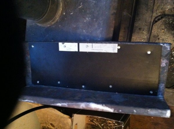

    Trying to light it up after repairs.
  2. Grizzly Adam
    Grizzly Adam Guest
    Temporary fix.

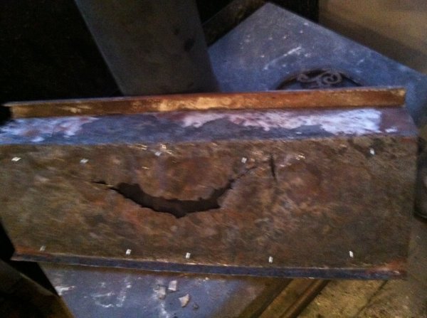

    Do you have a thermometer on that stovepipe? It looks like hat thing has gotten really hot a time or two.

    That would explain some of that warpage on the baffle.
    850° on the regular will do bad things to steel. Especially the thinner steel that the baffle and sides of stove body are made of.

    After working with it, I was taken aback by how thin it actually is.

    Is this the baffled out off...dont you have a blaze king? Is USSC the acronym for US Stove Company?
    Does look rusty?
    Maybe its from all the "good green wood"?
