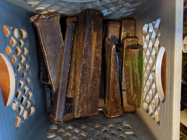

    Nicely done though, I wish I has that accuracy.

    That's a nice collection. I have three and one is MIA. None of mine have peened over tops though. They've split a lot of oak and gotten stuck in some pine. One time I had all three jammed in a pine crotch I should have just thrown out.

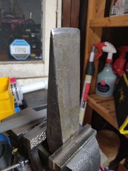

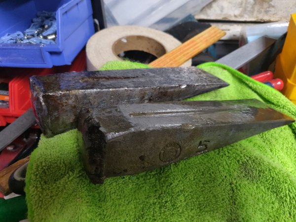

    I have two warren-teed 5lb wedges I soaked in vinegar and put an edge on. I also have 2 of those crappy estwing blue wedges from HD that I don't use unless I have to. I find that the angle is too obtuse on those and they tend to pop out. I've had to grind off the tops of the wedges as they peen over the top a few times.

    Not to sound like the safety police but I could grind the peened ends off of them if you like. I witnessed a dude get a chunk of metal imbedded in his face from a piece of a wedge that came off when he struck it with the mall.

    I would highly suggest trying to find a vintage wedge on eBay with a nice, slim profile, with little sign of abuse (i.e. the head all bashed up and in need of grinding)....They work so much better than the crap you can buy at the box stores.
    Make sure you wear your face shield and protective glasses when thou art grinding the wedges! :thumbs:

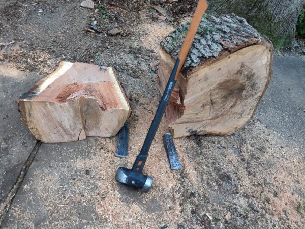

    Let me know how it works out for ya. It doesn't always work.....which is ok.....if there is a buried knot or some other form of ridiculousness, it ain't gonna happen. In that case I just transition to the wedge.
    Today I tried to walk the line on both these rounds to no avail and look what I found inside after using the wedges......

    Yes of course safety first!

    And I had to resort to using the chainsaw to noodle them a bit as well!

    If you look closely you can see the marks the wedges made on the inside of those rounds!

    Very nice of you to offer! You are right of course, it would be the safe thing to do.
