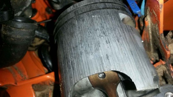

    Piston all damage at the exhaust port. The rest was clean.
    basod, Hammy, Barcroftb and 1 other person like this.

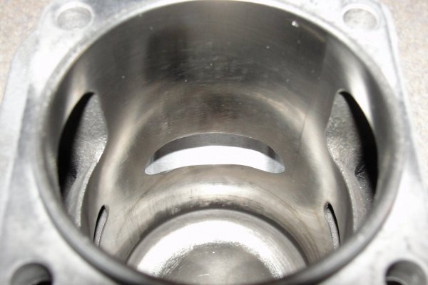

  3. mywaynow
    mywaynow
    719
    1,955

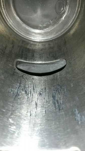

    Cylinder. It appears this is buildup, not grooved. If so is this something that can be repaired or should I get piston and cylinder?
    huskihl, Hammy, Barcroftb and 2 others like this.
  4. Casper
    Casper
    Jan 25, 2017
    1,710
    9,667
    I'd try removing aluminum first, then make the decision on ordering a piston and cylinder. Might be able to get away with piston, rings and whatever caused the burn down.

  5. mywaynow
    mywaynow
    719
    1,955
    Since the aluminum buildup is below the exhaust port the only concern would be to get the high spots down to protect the rings/piston, correct? Not really going to loose compression below the port?
    huskihl, Hammy, Barcroftb and 3 others like this.

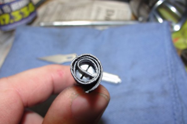

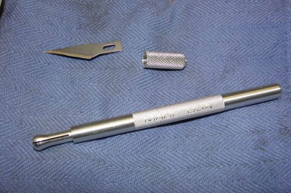

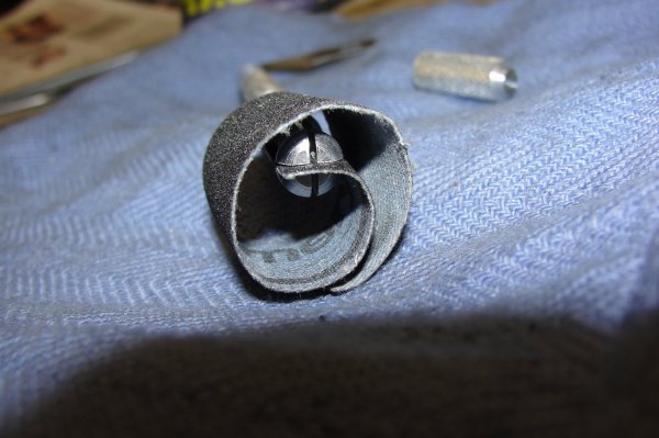

  6. The Wood Wolverine
    18,908
    121,936

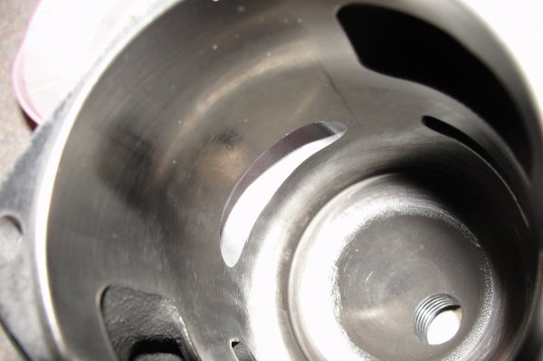

    A split mandrel on a drill or dremel will work fine. My first experience removing transfer I use an exacto and emory cloth.
    Before
    After
    basod, amateur cutter, Chaz and 4 others like this.
  7. mywaynow
    mywaynow
    719
    1,955

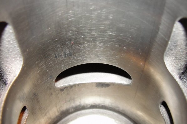

    Did what I could to remove the debris using the method in the previous post. Made real headway but the damage is just too much.
    Everything is below the surface now. Ordered piston/cylinder. Want this done properly.
  8. The Wood Wolverine
    18,908
    121,936
    I'd say it'll be fine. You just need to get the rest of the transfer outta there. I had an issue with a real stubborn spot and the guy that did those videos instructed me to go further after I sent pics. Used a rougher grit right on the spot. The plating is a lot tougher than you'd think. Keep going!

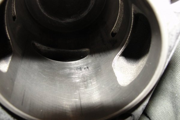

    I will keep working on the old cylinder to see if it cleans up better. I used 100 grit and 220 to get it where it is now. I don't think there is anything left on the surface and that all the remaining imperfections are scratches.

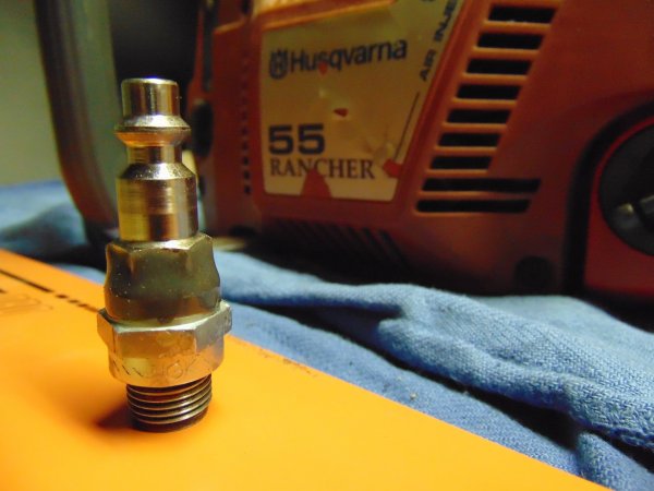

    I use regular saw gas/oil mix to clean the case. Problem is, you may very well have a bearing seal leak which led to the meltdown. That doesn't appear to be a simple blame it on ethanol diagnosis. More guys will chime in here, but I've never had it cause something like you've pictured, nor have I seen anyone post something similar. Last thing you want is to throw parts at it only to have it do the same thing in a long cut. IMHO you need to pressure/vacuum test this saw. Use a piece of inner tube in between the muffler and cyl and between the carb and intake or cyl, then either use an impulse line or a plug adapter to apply the vac/press with a mightyvac or similar. Soapy water with pressure will find a leak you can't.
    I removed the porcelain from an old plug and JB'd an adapter.
