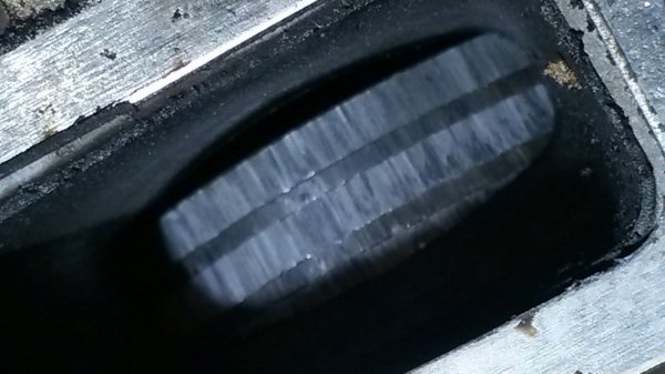

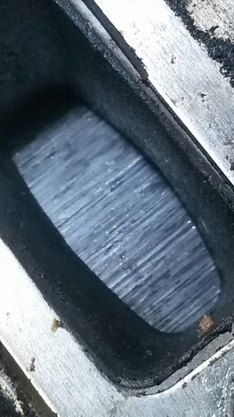

    Welp. Perhaps the culprit has been found:

    I'm gonna go out on a limb and guess that the crank bearings are bad and ruined the seals.

    Oh man, that sucks. :hair:
    That's why a compression test is needed..."it pulls over hard" doesn't necessarily mean much

    Actually it does. It means it's got compression, or it's almost seized. That's too bad & l'd bet Kevin's right about the seals.

    Yeah that's what I was fearing.
    Block off the intake and exhaust and pressure/vac test. You're in deep now.

    Intake side of the cylinder is nearly perfect. At least that which I can see over top of the piston. Guess I am going to pull the cylinder over the weekend and get a real read on how bad this is. What do I look for as far as the crank bearings being bad?

    Gent at the shop where I picked up the coil said to look at the exhaust side of the cylinder for damage. Apparently the garbage mixture of what is called gasoline in NJ may be the culprit. Ethanol clinging to water that evaporates at the hotter exhaust side leaving little to no oil on the piston/cylinder. Hope to post some less than ugly cylinder pics later. For now it's off to the woods to do my imitation of a squirrel.

    Looks a lot like our old Arctic Cat ZR440 that had an O ring in the head go bad. Coolant leaked into cylinder, and poof, no more residual oil. It looked very similar. I sent cylinder out to have it reworked and am putting it back together at the next opportunity.

    I wouldn't be so quick to assume that all was caused by ethanol. I've been running ethanol for ~30 years on all sorts of 2 strokes and the only time I got a burn down that bad was due to carburetor issues ( my tuning, not a mechanical issue) on a rotax 521. It was a cold cold weekend and the sled was running really nice and crisp.. well until.....

    If it was my saw I'd pressure/vac test it before I did anything. That looks like more than just ethanol damage.
