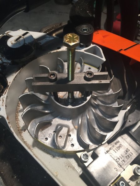

    Can you determine if the flywheel magnet reaches the coil gap at about top dead center? If you sheared a key, it would be off, preventing the saw from running, and could have been your slow death as it moved further from where it should have been.
    Hammy, basod, amateur cutter and 2 others like this.
  6. mywaynow
    mywaynow
    719
    1,955
    I got that inclination from a friend today. Looks like I need a puller to remove the fly? Piston seems tdc when the mag swipes the coil. I suppose a few degrees would not be visibly obvious though. Looks like a trip to the shop is in the near future. Hate paying other people to fix my chit....
  7. The Wood Wolverine
    18,908
    121,935

  9. mywaynow
    mywaynow
    719
    1,955
    I have steering wheel pullers that should do just this task.
