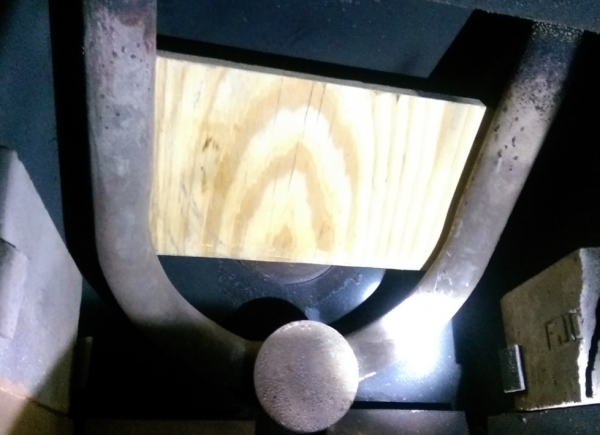

    Oh ok I was under the impression that 3/8 would warp due to its constant contact with heavy flame. Maybe I will just use 3/8 then. But I already made a template for 1" and it would fit the whole "battleship" vibe of this old stove. :rofl: :lol:
    Either way my suspiscions were concerned, anything thicker than cardboard will hit the thimble and stick out further. This piece of 3/4" plywood is 7.5" wide. I'm thinking I will make the finished plate 7" and call it good.
    I would expect your plate would be slightly different in dimensions from mine since you have the big mo and I have the mid mo. Bet ol' Big Mo was fun getting onto the hearth!

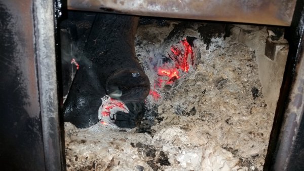

    Still have plenty of coals to relight if need be and still 73 in the house it's 46 outside and this was not a full load either. Now for some:sleeping: before the boys get up for school. 20141031_061906.jpg I loaded it to one side before I left to try to get a all night burn.

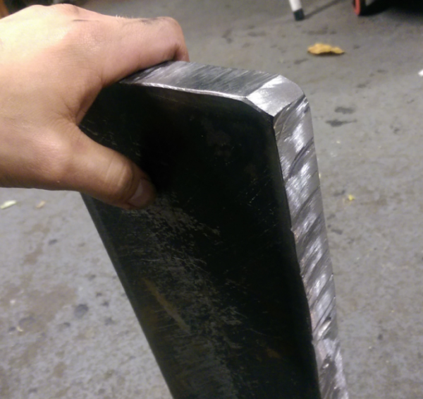

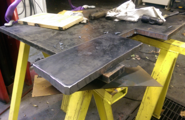

    Just wanted to share the finished product with you guys, thanks again.
    wildwest and WeldrDave like this.
  7. WeldrDave
    10,208
    56,315
    Nice job Razo! I'm sure you will see a big difference.:cool: If you get any back draft, you may want to take an inch off at a time till it flows smooth, but it looks like it will be fine!

    Burned some shoulder fires all weekend during the cold snap and it performed great. No negative effects on draft, burn times seemed impressive. I'm incredibly pleased with it!

    jetjr I noticed the exact same thing! Since my plate is on the thimble I was getting flames licking up along the sides right where you put your bricks. I was wondering what a solution would be and I guess I could cut relief in my 1" plate so that it slides down past the thimble to close that area but then I would lose a few inches overall on the baffle. I like you're idea of putting the bricks there, Maybe I'll just put some 1" plate coupons in there as a stop gap.
    Did you start a fire yet to see if those bricks stop the flames from shooting up along the sides yet?

    Yea its been working great. This is my first year ever burning a woodstove and I never burned it without the baffle installed so I have nothing to compare it to. But I feel I get pretty decent burn times and would NOT want to burn it without the baffle in place. If I load it up around 7:30PM I have a few coals left in the morning around 8AM when I get up. Not many, but some and the stove is still too hot to hold you hand on. I notice that once all the wood gets caught, and I adjust my air, I can cruise pretty steady for a very long time which I attribute to the nice secondary burn achieved with the baffle.
    The only shortcoming I noticed was the access holes where the flames could get up behind the baffle. I figured it was still better than no baffle at all but you have inspired me to try and block mine off as well.
