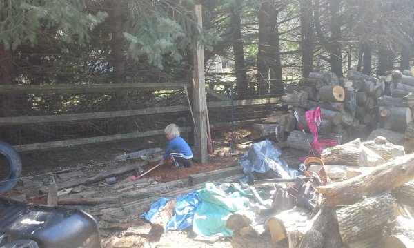

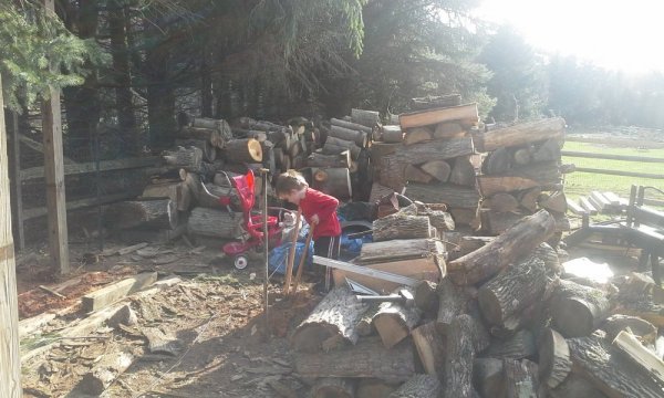

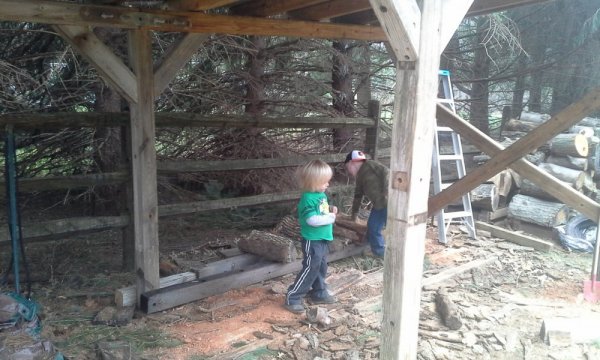

    Got all the post in the ground and the tops cut level. Its a little out of square but I'm ok with that crossarms are never quite the same dimensions and usually a little bowed. I will get the roof as square as possilble and I'm good with it. The boys helped out a while too.:D:thumbs: PHOTO_20140405_150259.jpg PHOTO_20140405_171047.jpg Sorry about the mess but I did not feel like restacking only to have to stack again.

    Thanks for the pics. Looks like the guys are liken it…

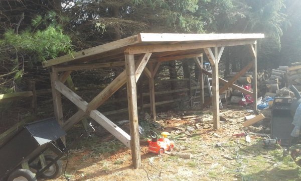

    As you all probably know the woodsheds done. Next on to the splitter hopefully that should be up and running tomorrow afternoon. No bad luck of course. PHOTO_20140408_165346.jpg

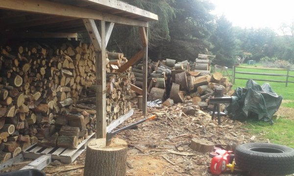

    Got a little stacked today. Supper time and rain convinced us to stop. Hopefully after work tomorrow the splitter should be all assembled. PHOTO_20140411_180634.jpg did not get any pics of how much we got done. Not a lot but probably 2 feet high or so between end and middle post. Its one year old ash, maple and some oak. I know the oak won't be prime but hopefully by the time I get to it it will be 2 years old at least.

    You gotta get some old glass insulators up on those cross arms…;) Lookin' good and great to see the guys learning how to stack… :yes:

    I have some but am worried I would bust them up. Keep them In the garage mostly and have one on the mailbox post.

    Jet not a critique just a bit more of experience when you try to use short pieces of cribbing on the end of a stack you're asking for it to tip over in the next couple years.
    The long crib will settle less than the short piece and could give you some headaches as the wood dries/settles.
    We all "use what we have" until learning it's not worth the time to restack that section...well it's worth the time cause the wood is seasoned just not worth the pita headache

    I see what your saying and to be honest I know better and had a brain fart. It started rolling on me as I was stacking. Good catch in seeing that. Don't worry I have big shoulders and kind of startes this thread a for extra advice/critique. Experience trumps a lot of things.

    Great job with the woodshed! That thing is really built well.. Might come in handy for a tornado shelter too... :)

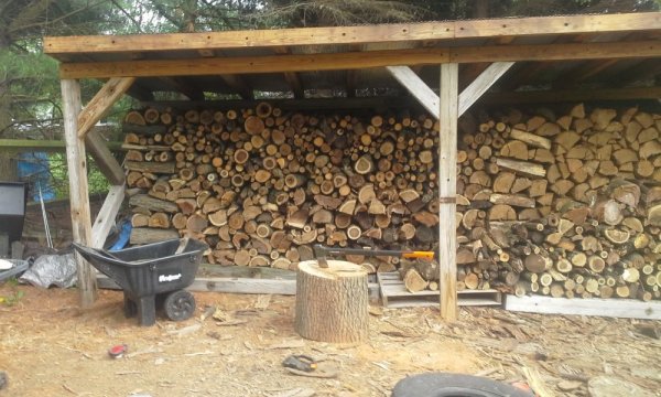

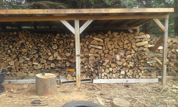

    Bought a HF moisture meter today
    Most of the locust seems to be twenty or less in a fresh split piece. The other standing dead is a little above twenty. Got some more stacked and have a little more to split and stack in shed. Think around two loads and it will be full. PHOTO_20140515_161920.jpg PHOTO_20140515_161925.jpg PHOTO_20140515_161946.jpg

    Way to go Jet! Looks great. Feels good doesn't it? Lots of work under that dry roof now… :yes:

    Yea, great job! Wood shed looks even better full of wood. :)

    Sounds like you're good to go, lookin good to :thumbs: gettin er filled
    It's good to know where your at with moisture content
