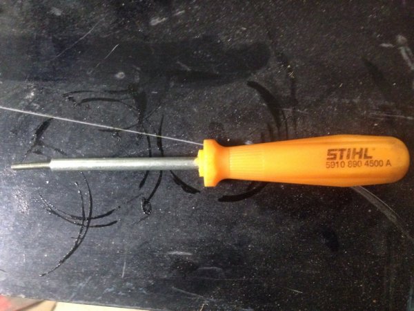

    The actual tool to pull those is just a small machine thread screw end with a screwdriver handle. And left hand threads.;)

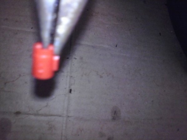

    Here I am posting how I did it. Not for a who's right thing but if it helps someone remove them in less than 2 hours, great!
    This is the limited cap out of my 650 and the very set of pliers I used. Screwdrivers are pretty self explanatory so I'm not posting them.

    Interesting looking cap though, with just that bump as the limiting factor. If I'm looking at it correctly.

    Yes if u cut that small tab off and reinsert it you van get the full range of motion out of screw and I think it was mom said that it helps hold the setting and not vibrate out of adjustment.
