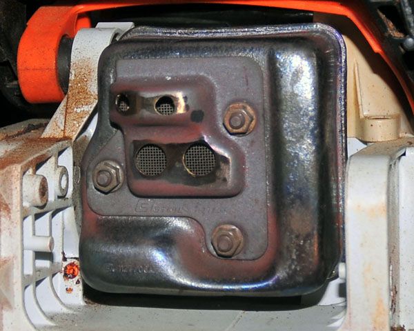

    I kinda like them loud :)
    The 290 series don't forget to mod the cover plate also
    They should also be gutted (baffle taking out IMO)

    I tore my house apart looking for the copy I printed of the picture when I modded my saw. Couldn't find it online, couldn't find it in my saved files, finally found it in the house.

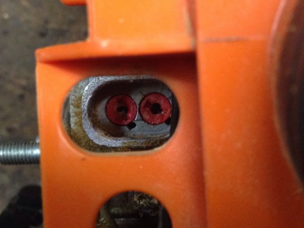

    Ok... Just did the muffler mode. But as I was getting ready to tune the carb. I started to try to turn the H side and it was already against the way against the top side. The Low was just off the top. This seems quite a bit difference than what the manual shows as a standard setting. Is this odd?

    Sounds like there are still limiters in place on the carb screws. Those need to come off.

    Have u pulled the red limiter caps out yet? That saw should not even run if its all the way out?? It should bog like crazy n smoke.

    Ok...will those be noticeable ( inside or outside of carb)? I assume pull the whole top cover off.... Then?

    pull the plastic cover off. They are inside the hole recess but around the screw head. Grab them with needle nose and pull out. U can cut the tab off and slide back in. I leave mine out but some say it keeps the screws from vibrating out of adjustment.Personally I not had that. Once tab is cut u can turn it like its not there.
    And yes there easily seen when u look.

    These red things?
