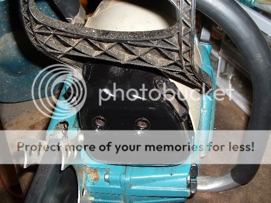

  20. PullinMyPoulan
    PullinMyPoulan
    Jun 19, 2014
    603
    1,554
    Manistee National forest
    Heres a hack job of one I did for my huskered copied it from a Wicked Work Saw that I saw:binoculars: NCM_0134.JPG
