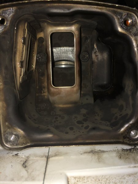

    Opening that exit made a pretty decent saw into a torque king on mine
    Add a MaxFlow air filter and you will see even more grunt

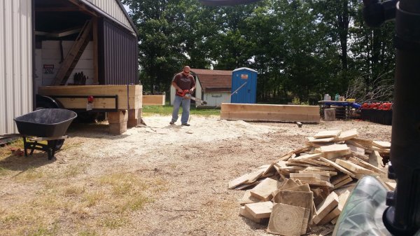

    Back pressure in a saw isn't needed as much as most think. On a dirt bike with a tuned pipe? Yeah... But at my last GTG blsnelling ran his fastest time with his Ported 661 with NO front cover on. Yep. No cover. It sounded nasty and ran even better. If I recall it was a second and a half (or better) in a 20" x 20" Cant.
    This isn't Brad, it's HittinSteel, but you can see the Cants. Most every saw there had huge holes in the front. :) Loud? Yes.. Fast.. Yes ;)

    DexterDay is correct. There have been numerous tests done and the back pressure does not do anything for the saw unless it is a tuned pipe. I make a lot of my muffler mods larger than the exit port of the exhaust on the cylinder and the saws respond well.

    may have to look into removing the inside baffle thanks for the replies, as of now I don't plan on porting it but that may change further down the road.
